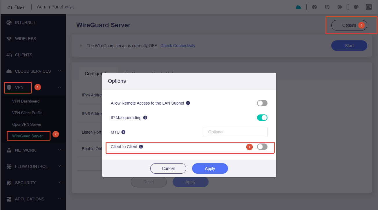

Please go to the router acting as the server and enable Client-to-Client under Admin Panel → VPN → WireGuard Server → Options.
This will allow communication between VPN clients:
