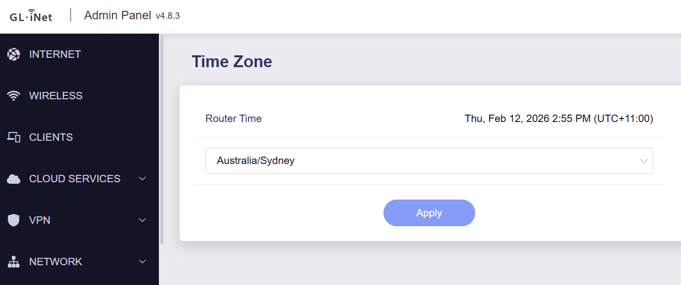

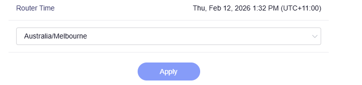

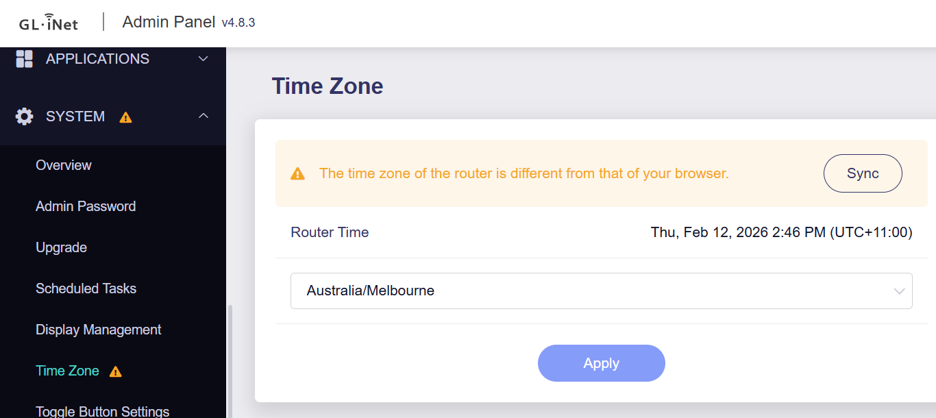

I ran the command and same as what you have above. Issue is, when I sync the time zone, it sets it to Sydney (same time zone) but when I select Melbourne (where I live) it comes with the warning again. As per the below
and this (when set to the wrong local)
Actually I think I solved my own issue. As it’s time zone and not local. You need to Melbourne to Australia/Sydney as it’s the same time. It’s needs to include Melbourne as we’re the same as ACT (Canberra) and NSW (Sydney) so add in Victoria (Melbourne) and it’ll be all good :slight_smile:
Oh and remove the Australia/Melbourne from this list
May I know Melbourne is same as Australia/Sydney? and is it UTC+10 on Melbourne?

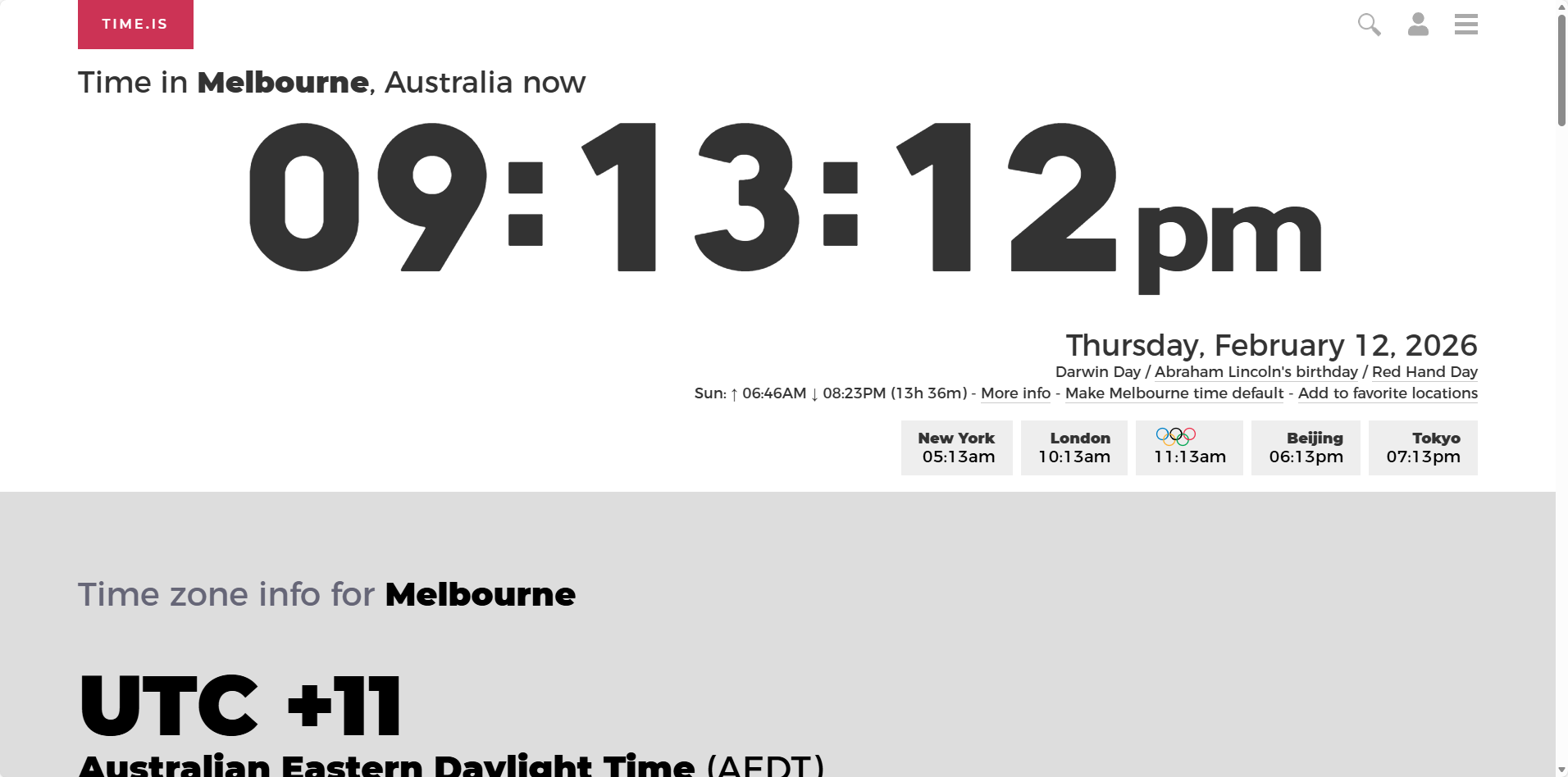

But we see online that Melbourne is UTC+11:
So we can remove the Melbourne from the timezone list.

Yes, Melbourne is the same as Sydney. We’re both on daylight saving time, Sydney/Canberra/Melbourne are always the same. It’s +10 but during DST we’re +11
Just add Melbourne to Sydney/Canberra and it’s all good :slight_smile: (check the time for Sydney and you’ll see)
