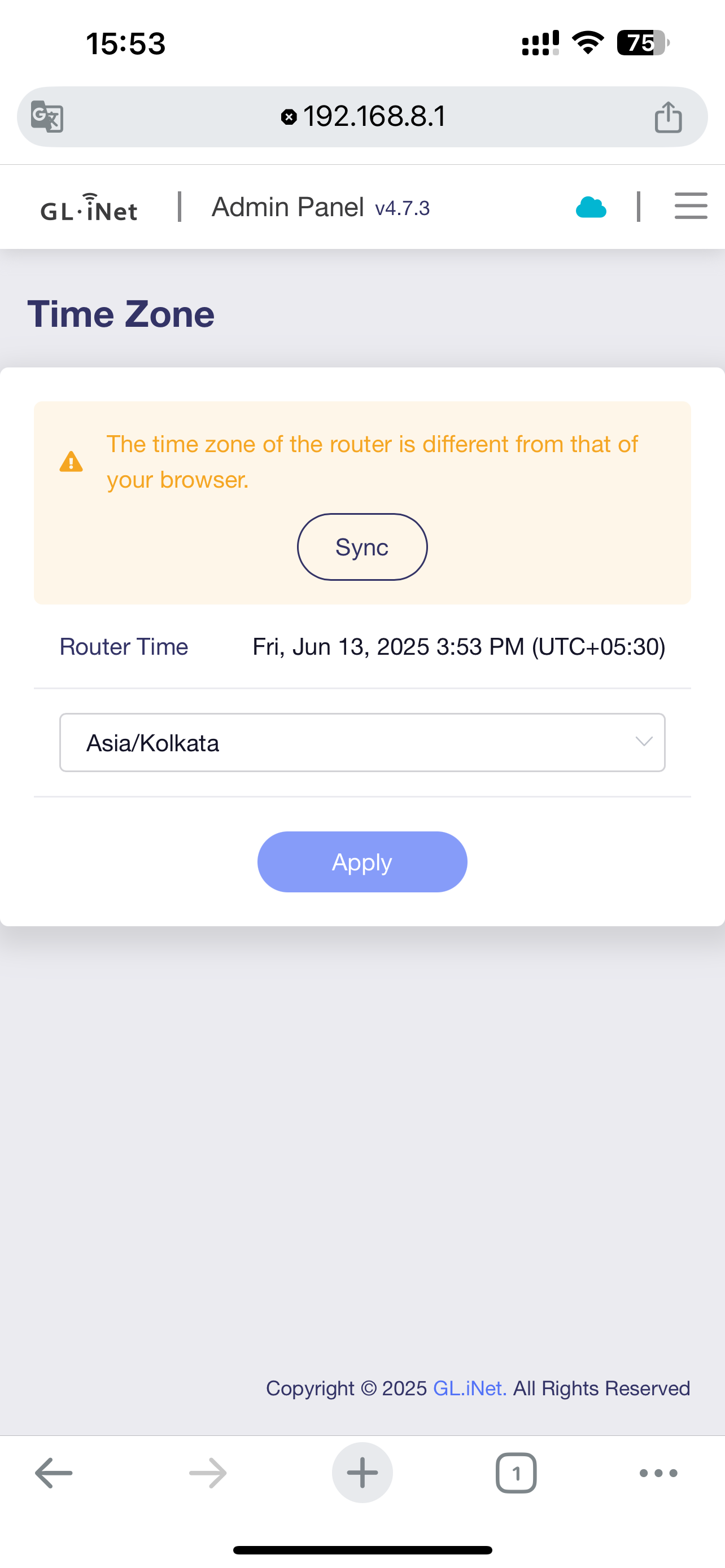

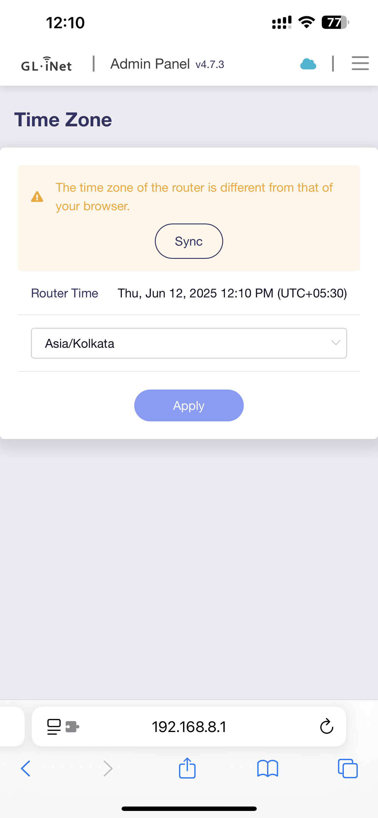

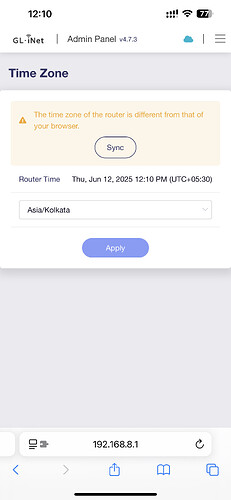

I get the following error message. I changed the time zone already a couple of times. My iPhone is using the correct time zone as well. Do you have any idea how I can solve that?
It was the same with the 4.7.2.
If I push the sync button I just get UTC time. But I am not in that time zone.

I am in kolkata time zone / India. I have no other browser on iPhone or iPad, just safari.

It’s the same with Google Chrome:
Pushing the Sync button leads to the UTC time. The message stays. :man_shrugging:t3:

In addition, the time zone settings of these related regions will also appear synchronized to "UTC" instead of region names: "Chennai, Kolkata, Mumbai, New Delhi, Helsinki, Kiev, Riga, Sophia, Tallinn, Vilnius".
This warning message of GUI cannot be turned off. But we will improve this issue.
Update:
These region/country will be added in the v4.9.0 firmware. Thanks.
