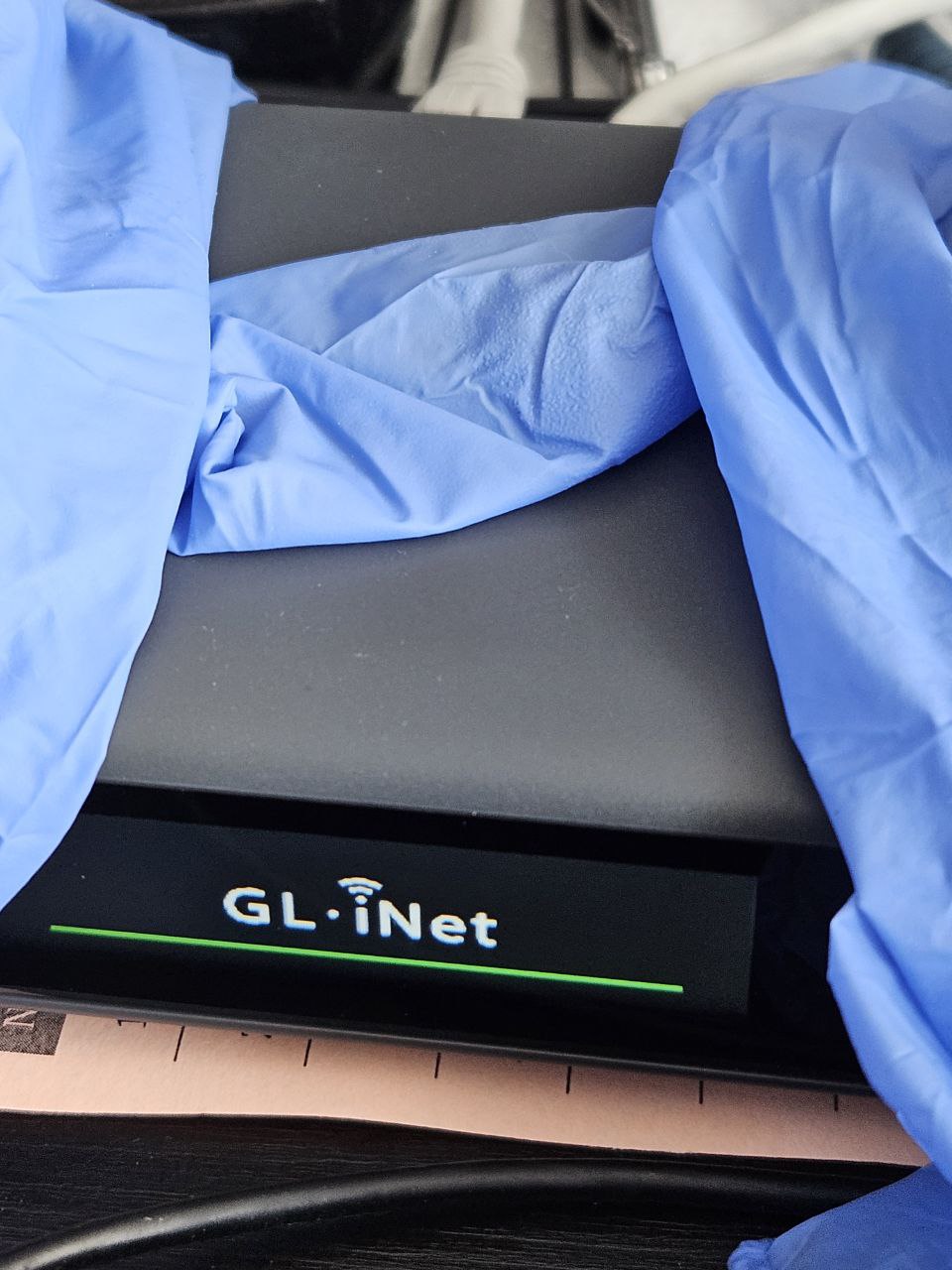

Slate 7 – Beta Firmware (4.7.2) Screen Frozen on Boot
I installed the beta firmware (4.7.2) for the Slate 7, but the display became frozen on the bootup screen and stayed there indefinitely. The device appeared to be working behind the scenes, but the screen itself never updated beyond the GL.iNet logo.
I tried using the Display Management feature in the web UI and rebooted the device multiple times—no change. The screen remained frozen, and it never turned off either, which may be a separate bug. Eventually, I reverted to the stable release to restore functionality.
Is this a known issue with the beta? Are there any details available on a newer beta version that might address this display problem? I’d like to continue testing newer firmware if this bug has been fixed or if a workaround exists. Let me know if there’s an updated build or ETA on the next beta push.
Thanks in advance.

So I can confirm 4.7.2 has an issue with the screen - it is indeed frozen. What wonders me most is the fact it worked initially (upgraded from 4.7.1 to 4.7.2 beta), but after some reboots, the screen is always stuck at the loading screen (green bar).
Downgrading to 4.7.1 fixes the issue. However, then getting back to 4.7.2 re-introduces the issue. But still, I do not know why it initially worked. I don't get it.

So what I can tell from testing yesterday, the problem is caused by one of the files which are also included in a backup file you can create in LuCi. Restoring the router to factory fixes the issue, but then restoring the backup will again cause the screen to freeze.

I just updated to firmware 4.7.2 release2. The screen freezes only when 'Security>Admin Panel > Force HTTPS' is turned on.
Thanks for report. We did reproduce this issue in my Slate7 with v4.7.2.
We are checking the codes.

This is telling you that the router is in uboot failsafe mode. In this mode, you need to flash firmware according to the uboot guide.
Mine freezes on the loading screen(green bar) as well after trying to update all of the opkg packages
You cannot do this. It will break not only the screen but also everything. Please reset the router.
Alzhao, how are you? That's exactly what happened to me. I did the normal update to 4.7.2 and it solved the screen problem, but when I went to the plugins section, there were 42 updates. I ended up doing all of them, and after restarting the router, it crashed. I managed to solve it by resetting it via U-Boot.

Well, reset does nothing, I unbricked my router via Uboot
