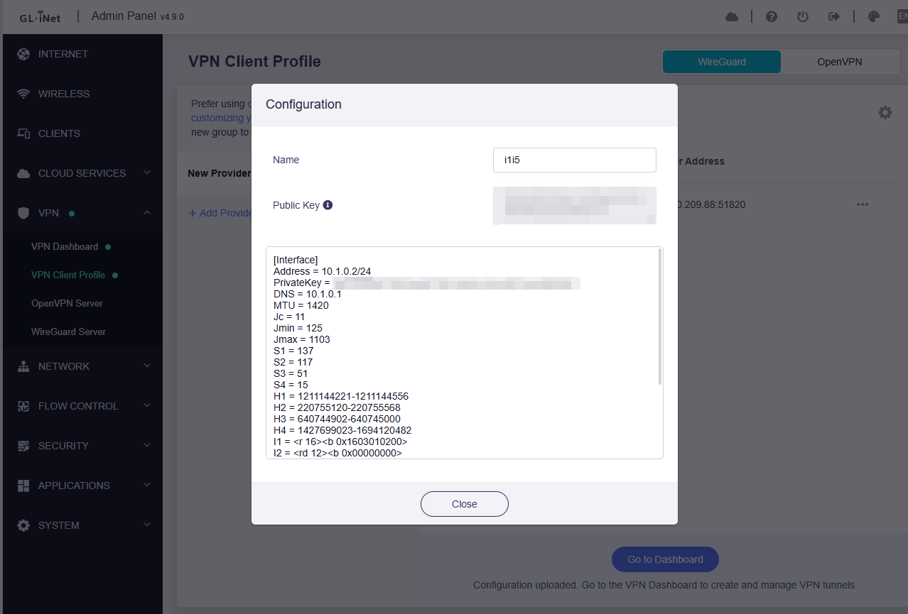

I just purchased this unit and discovered it does not support Amnezia WG2 protocol.
I can import the config from my Flint 3 however if I try to edit it there is a red border around the config and wont let me save any changes.
I get this when I try to connect
daemon.notice netifd: wgclient2 (4322): Unable to parse H1: `762300480-76230'
Am I right that this is the case and if so when will there be support for it?

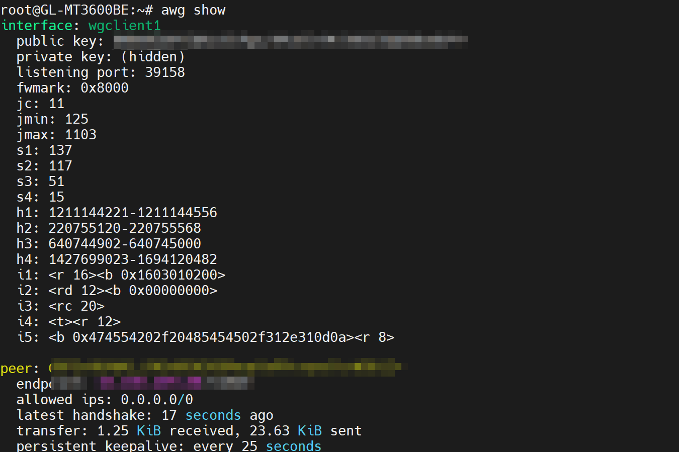

Yes I remember this being the case previously and although I don’t own this device, glinet earlier said they only supported version 1 and support for version2 would be added later.
It was later added to the beryl atleast
But this is post version 4.9 and I see slate 7 pro is still on 4.8.4 so it’s a waiting game now.
