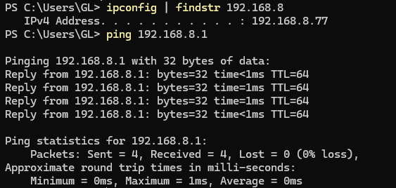

Regarding Question 1: To access the router while it is in Extender mode, you will need to manually assign your PC a static IP address within the router’s original LAN subnet.
Example: If your router’s LAN IP is 192.168.8.1, connect your PC to the router's LAN port and manually set your PC’s IP address to 192.168.8.77 (with a subnet mask of 255.255.255.0). You should then be able to reach the Admin Panel at 192.168.8.1.
  • BE3600 in extender mode with upstream network 192.168.121.0 and LAN IP address 192.168.8.1:
  • PC connect to LAN port of BE3600 with IP address 192.168.8.77 is able to communicate with BE3600 via 192.168.8.1.

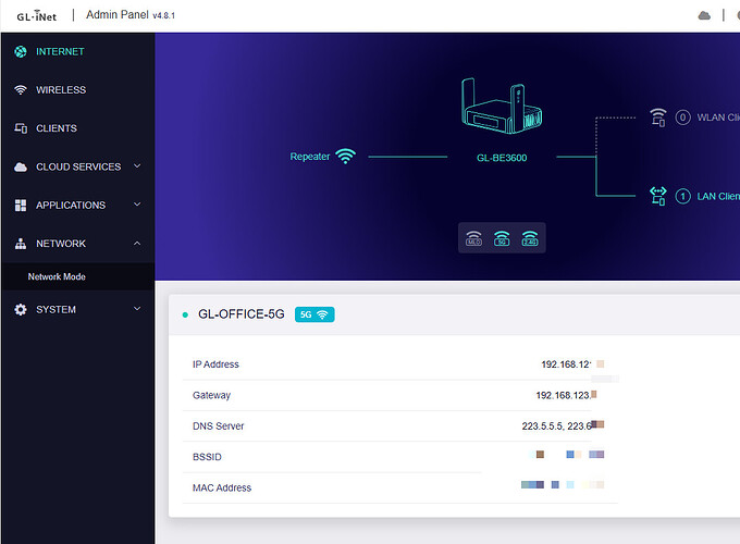

For Question 2: We tested the BE3600 locally using firmware v4.8.1 in Extender mode with a Wi-Fi Status Schedule enabled, but we were unable to reproduce the issue.
To help us analyze why it isn't working on your end, please use the access method described above to log in to the Admin Panel and check the following:
  • Internet Status: Does the Internet page still show as connected to the upstream Wi-Fi?
  • Wireless Settings: Are the 2.4GHz and 5GHz radios showing as "Enabled" in the Wireless menu?

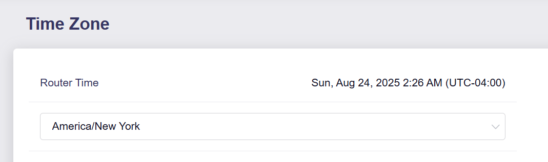

  • System Time: Is the time displayed in System > Time Zone correct? The schedule relies on the correct local time to function.

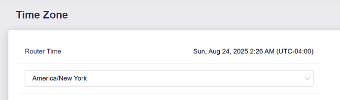

The firmware version is 4.8.1. THe radio shows “off”. The timezone is correct, but the time itself is way off. The below screenshot was taken at 10:04AM ET.
There is no “sync” button like this docs page: Time Zone - GL.iNet Router Docs 4
Sending the log in a private message
I set the timezone to a wrong one and back and got the sync button and pressed it. It is correct now - but I’m concerned about why it would not be correct on it’s own. Log was sent as requested.
