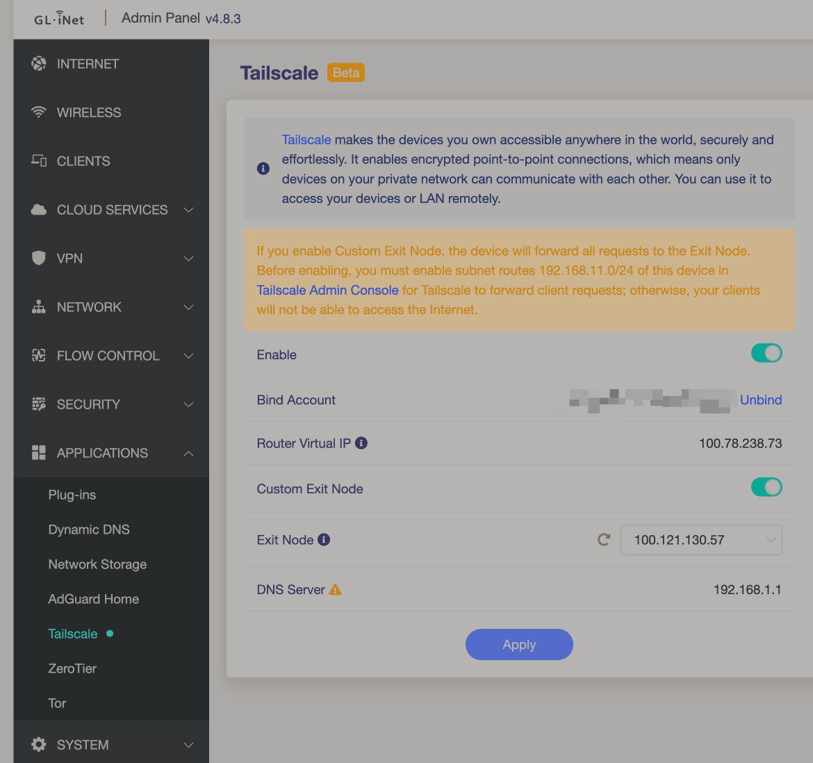

I am experiencing an issue with Tailscale exit node routing on a GL.iNet Slate 7 router, and I would appreciate any guidance.
Device / Firmware
  • Device: GL.iNet Slate 7
  • Firmware Version: 4.8.3
  • OpenWrt Version: OpenWrt 23.05-SNAPSHOT
Tailscale Setup
  • The router is connected to my Tailscale tailnet.
  • All subnet route access is granted.
  • I enabled the Custom Exit Node feature on the router and selected my exit node hosted on a VPS.
Intended Use Case
One of the main reasons I purchased this router was to use Tailscale at the router level, so that all devices connected to the router can use my Tailscale network and exit node, even if those devices do not have Tailscale installed.

When I enable Custom Exit Node on the Slate 7 router and select the same exit node:
Expected behavior
  • All traffic from devices connected to the router should route through the selected exit node.
Actual behavior
  • The public IP detected from devices connected to the router remains my local ISP IP, not the VPS exit node IP.
This suggests that traffic is not being routed through the exit node, even though it is selected in the router interface.

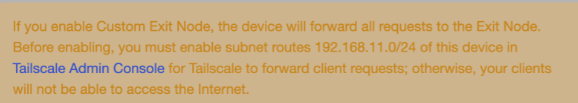

Did you approve the subnet suggested by Slate 7 in the Tailscale Admin Console?

In addition, the Slate 7 is currently using the upstream router as its DNS server, which usually cannot be accessed through the Tailscale tunnel.
Please go to Network → DNS and manually configure an available DNS server.

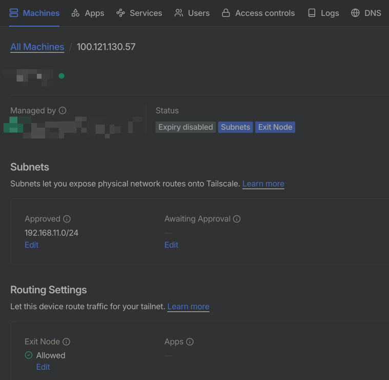

Yes, the subnet routes are approved in the Tailscale admin console:

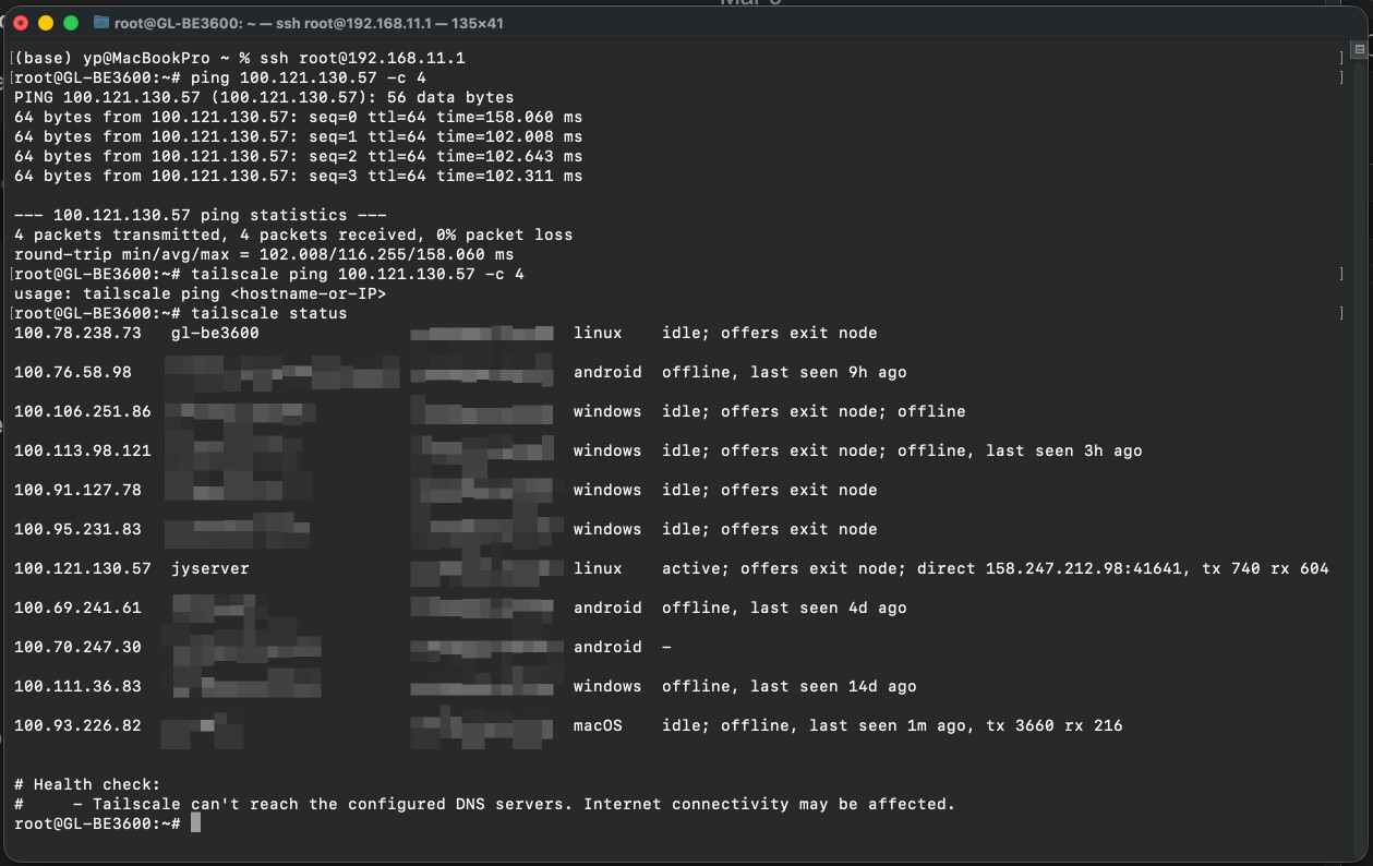

It looks like the Tailscale exit node is not working.
Please SSH into the router and run the following commands to check:
ping 100.121.130.57 -c 4
tailscale ping 100.121.130.57 -c 4
tailscale status
Here is the result of running those commands:
I noticed the health check warning message.
The thing is, I see the same message on the android app on my phone, on which I have no problem using the same exit node..
I would appreciate any advice to get this exit node feature work on Slate 7 router.
Thanks.

In addition, we noticed that jyserver (Tailscale IP: 100.121.130.57) is also advertising the route 192.168.11.0/24, which is the same as the Slate 7’s LAN subnet.
This appears to have caused the LAN subnet route advertised by Slate 7 to become ineffective.

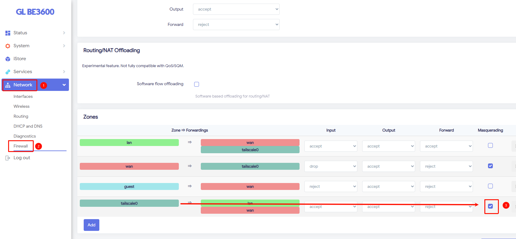

To work around the routing issue, we enabled Masquerading for the Tailscale zone in LuCI → Network → Firewall
The Tailscale Custom Exit Node should now be working properly.
