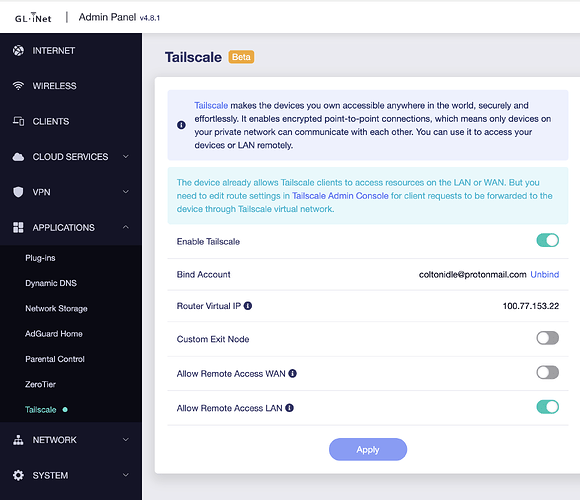

  2. Screenshots of GL UI → Applications → Tailscale and the Tailscale admin panel, so we can review the configuration

  1. 4.8.1 is the firmware
  2. Screenshots attached

The configuration looks well.

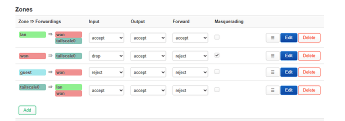

From firmware v4.8.x onward, Tailscale operates within its own firewall zone, and forwarding to LAN and WAN is handled automatically according to the router’s configuration. Therefore, manually assigning firewall zones is generally unnecessary.
One possible difference is that masquerading is enabled on the WAN firewall zone but not on the Tailscale zone.
This may help in some scenarios like remote Tailnet devices don't support routing, but please be aware that it will perform source NAT, meaning remote Tailnet devices will only see the Slate 7’s Tailscale IP instead of the original LAN client IP (192.168.8.x).

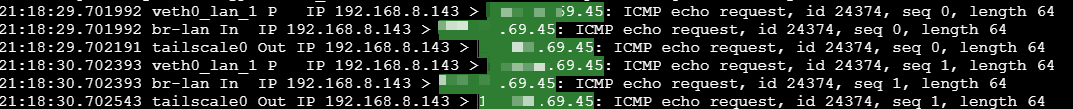

Thank you for providing remote access.
We perform a detailed packet capture to pinpoint the cause of the connection issue.
Our analysis shows the following:
  1. Direct LAN Routing: When the router sends requests using the local LAN address as the source, the target server does not respond to the ICMP (ping) requests.
  2. Masquerading (SNAT): When we enable Masquerading in the tailscale0 firewall zone—which translates the LAN source address to the router's Tailscale IP—the target server responds successfully.
