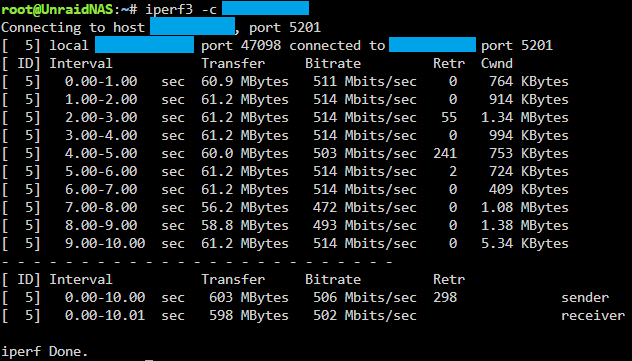

I was only able to achieve 500Mbps with the cpu at roughly 3.5/4.
It was either a glitch or some mistake because I’ve not been able to repeat those results, even on hardwired. You can see my updated results here: Report: VPN Speeds on Flint 3 and Slate 7. Also keep in mind that the firmware I originally tested on was a 32bit pre-release firmware.
