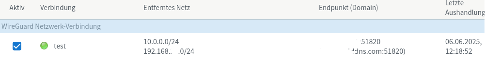

With this setup, I can import this config to my Fritz Box without any errors.
Also a connection is established.
On my Slate 7 I can also see a green dot behind this VPN connection, so atleast some packets will be accepted.
