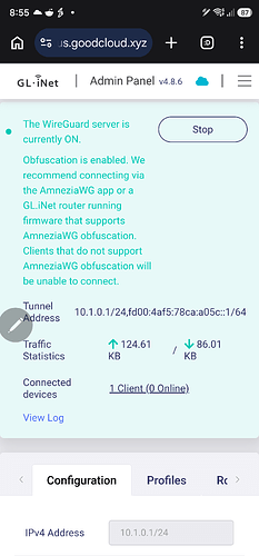

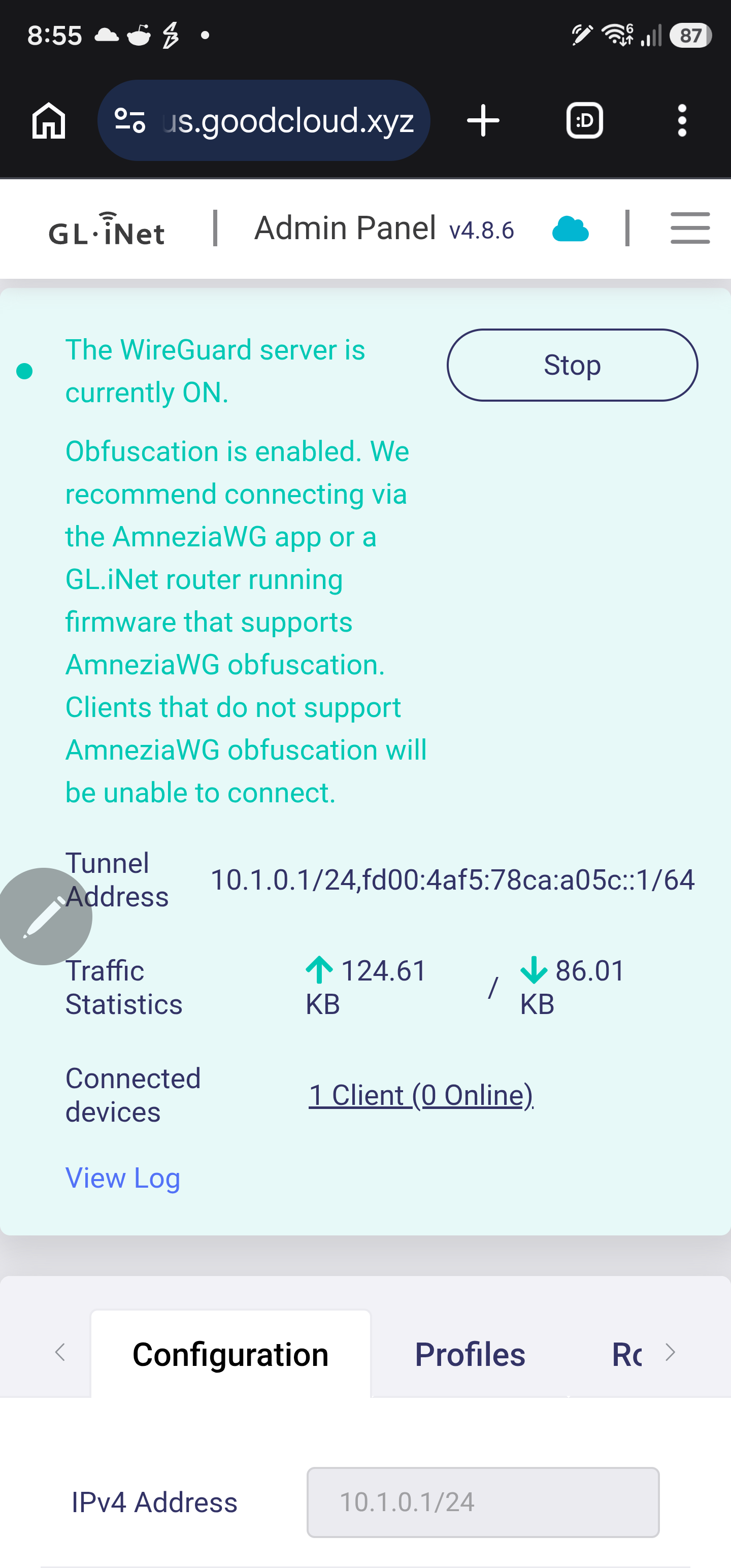

Hello there,am just got my Brume 3 yesterday and am trying to set up AmneziaWG.
It seems like the AmneziaWG is successfully setup,but I can't connect though my Slate7 which is using a mobile 5G network.
While the AmneziaWG app that is on my phone do successfully connect through my phone's 5G network to the Brume 3 that is at my home.The Brume 3 is connect though my primary router's LAN and I had enabled the port forwarding on my router and enabled the Brume 3's DDNS.
Slate7 is on 4.9.0 and Brume 3 is on 4.8.6
How do I solve this? Thank you in advance.
Edit:The 1 client that on the second screenshot is from my phone connecting to the server.

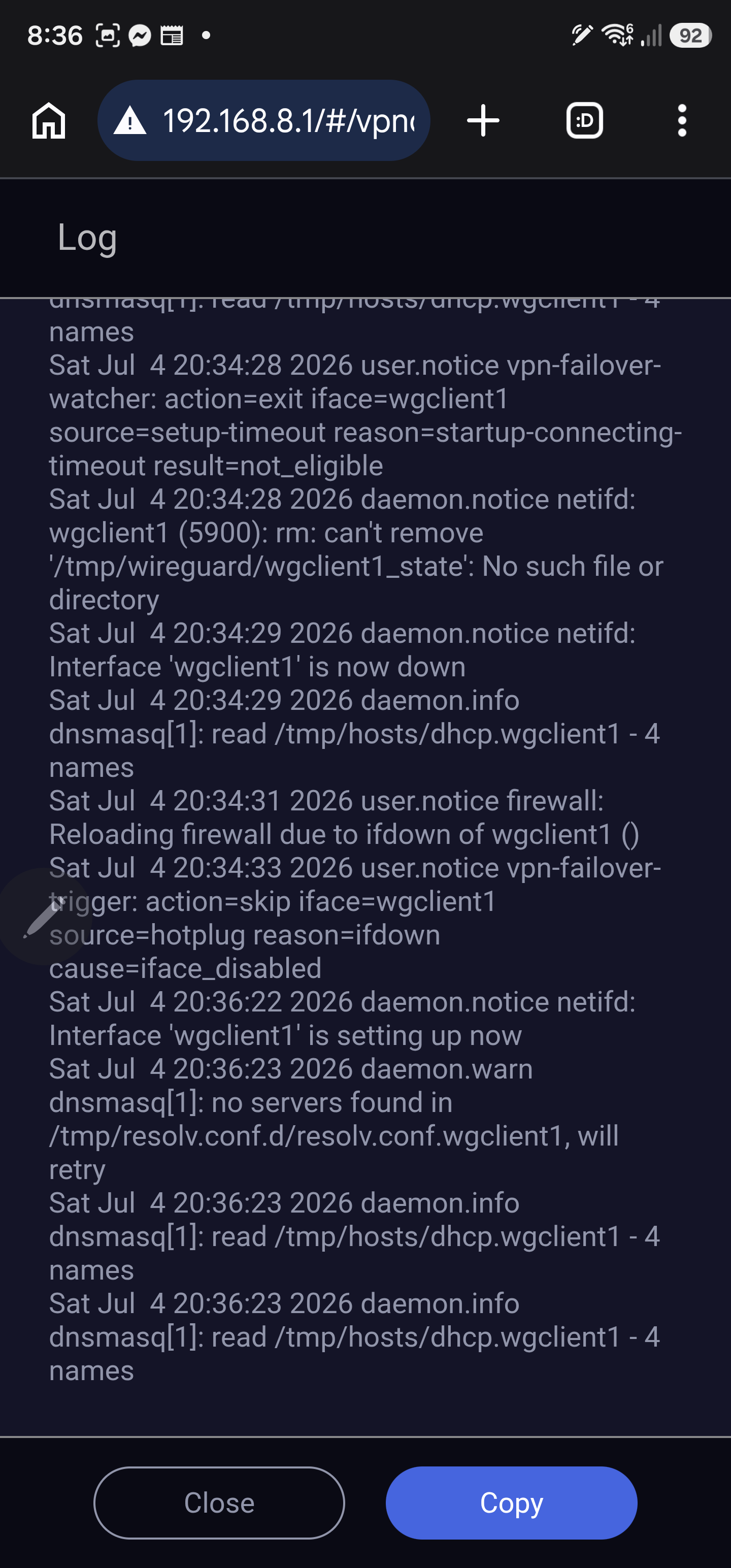

I think it mostly would be the glinet ddns,it goes down randomly that I can't connect,and I need to reboot my brume 3,wait a while.Then it would connect.
I still could reboot it through goodcloud,but the ddns is unavailable.
When the AWG connection fails again, please do not reboot the Brume 3, could you please check whether the DDNS domain can still resolve correctly?
In addition, please export the system log and send it to us privately by DM.
These details will help us check whether the issue is caused by DDNS resolution or the gl-ddns process.
