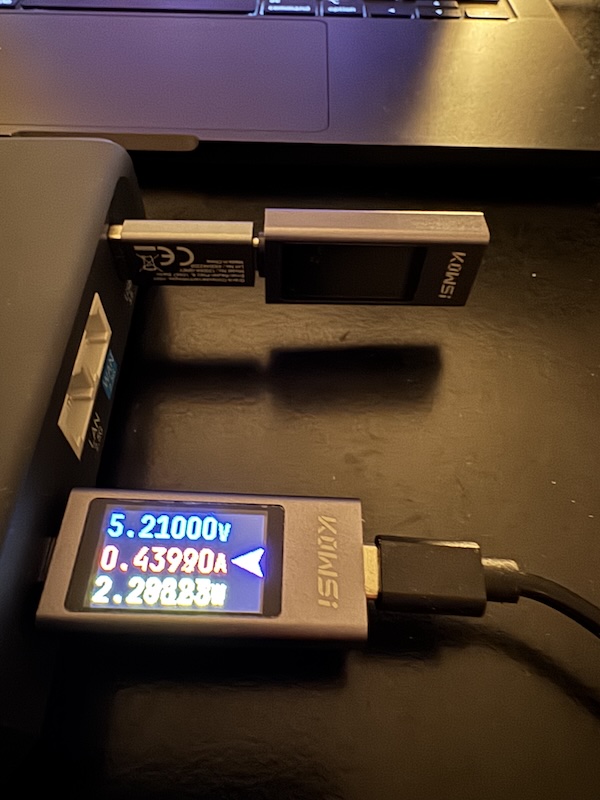

it seems like if you connect the SLATE 7 to its USBC power connector the USB-A port is not functioning. If it is only my unit or it is a general restriction (what I fear) needs to reconfirmed with the GL.iNet Tech support.
The current Slate 7 Tech Spec states for Power Input are 5V/3A, 9V/3A, 12V/2.5A

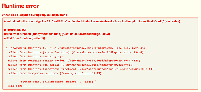

Next I tried to install Docker - from the package manager in the GLI interface and via LUCI in various ways. No luck.
I tried the "docker run hello-world" to confirming functionality.
Sometimes it was downloading from Docker Hub, but the ... a long wait,
sometimes a reboot of the whole Slate 7!!!,
clicking through the Docker interface in LUCI sometimes an error message like this showed up

There is a lot to try to take in there.
One portion that seems easier to understand and answer regards power and USB function.
5v/3a only gives 15w.
The slate 7 spec says the router uses less than 18w without USB.
So your 5v/3a is only barely enough to supply the router without USB function. For USB support you need to use a bigger power supply.
The Slate 7 is using less than 2W (booting) to little less than and 4W - 5W idle
Using the power supply with USB-C PD (the Slate "negotiates" 12V) it takes about 10 seconds to activate the USB-A connection (with 5V out)
Using a 5V only USB-C Power source (either from the 3A PoE converter or a normal PowerBank the USB-A connection is no showing any power...
(the router (except USB-A) is functioning normally with a 5V and 12V power supply)
This 10 second USB-A power-up delay is interesting - my hypothesis was that the USB-A power is "generated" from a step down converter from the Voltage-in to the 5V USB-A (so to get the 5V out you would typically need some >5.5V to make it work). The 10second USB-A power up delay is hinting for a more complex scenario...)
So let's hope it's a software bug, but not a hardware design flaw.........
