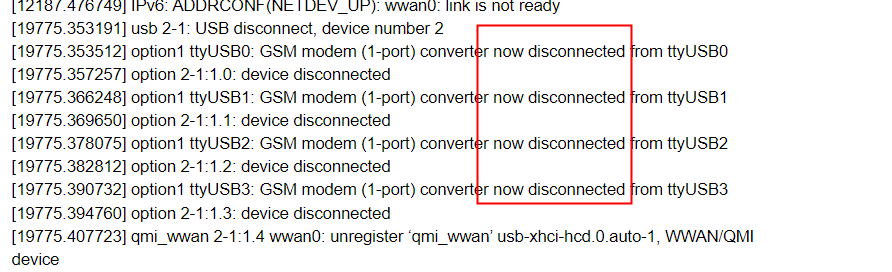

I guess my celebration was a little premature. It connected but when I needed to move the router and tried to reconnect it will not reconnect again.
I tried running the AT+QCFG=“usbnet”,0 and reconnecting and it still won’t recommend.
Any suggestions?
Here is the last few entries in the syslog
Wed Jul 19 18:10:35 2023 daemon.notice netifd: modem_2_1 (18646): Stopping network modem_2_1
Wed Jul 19 18:10:35 2023 daemon.notice netifd: modem_2_1 (18646): Command failed: Permission denied
Wed Jul 19 18:10:35 2023 daemon.notice netifd: Interface ‘modem_2_1’ is now down
Wed Jul 19 18:10:35 2023 user.notice mwan3[18653]: Execute ifdown event on interface modem_2_1 (unknown)
Wed Jul 19 18:10:35 2023 user.info mwan3track[11690]: Detect ifdown event on interface modem_2_1 (wwan0)
Wed Jul 19 18:10:35 2023 user.notice mwan3track[11690]: Interface modem_2_1 (wwan0) is offline
Wed Jul 19 18:10:37 2023 user.notice firewall: Reloading firewall due to ifdown of modem_2_1 ()
Wed Jul 19 18:10:50 2023 daemon.notice netifd: Interface ‘modem_2_1’ is setting up now
Wed Jul 19 18:10:50 2023 daemon.notice netifd: modem_2_1 (19978): Waiting for SIM initialization
Wed Jul 19 18:10:51 2023 daemon.notice netifd: modem_2_1 (20020): Stopping network modem_2_1
Wed Jul 19 18:10:51 2023 daemon.notice netifd: modem_2_1 (20020): Command failed: Permission denied
Wed Jul 19 18:10:51 2023 daemon.notice netifd: Interface ‘modem_2_1’ is now down
Wed Jul 19 18:10:51 2023 user.notice mwan3[20042]: Execute ifdown event on interface modem_2_1 (unknown)
Wed Jul 19 18:10:51 2023 user.info mwan3track[11690]: Detect ifdown event on interface modem_2_1 (wwan0)
Wed Jul 19 18:10:51 2023 user.notice mwan3track[11690]: Interface modem_2_1 (wwan0) is offline
Wed Jul 19 18:10:52 2023 daemon.notice netifd: Interface ‘modem_2_1’ is setting up now
Wed Jul 19 18:10:52 2023 daemon.notice netifd: modem_2_1 (20252): Waiting for SIM initialization
Wed Jul 19 18:10:52 2023 user.notice firewall: Reloading firewall due to ifdown of modem_2_1 ()
Wed Jul 19 18:16:59 2023 daemon.notice netifd: modem_2_1 (8083): Stopping network modem_2_1
Wed Jul 19 18:16:59 2023 daemon.notice netifd: modem_2_1 (8083): Command failed: Permission denied
Wed Jul 19 18:16:59 2023 daemon.notice netifd: Interface ‘modem_2_1’ is now down
Wed Jul 19 18:16:59 2023 daemon.notice netifd: Interface ‘modem_2_1’ is setting up now
Wed Jul 19 18:16:59 2023 daemon.notice netifd: modem_2_1 (8096): Waiting for SIM initialization
Wed Jul 19 18:16:59 2023 user.notice mwan3[8095]: Execute ifdown event on interface modem_2_1 (unknown)
Wed Jul 19 18:16:59 2023 user.info mwan3track[11690]: Detect ifdown event on interface modem_2_1 (wwan0)
Wed Jul 19 18:16:59 2023 user.notice mwan3track[11690]: Interface modem_2_1 (wwan0) is offline
Wed Jul 19 18:17:01 2023 user.notice firewall: Reloading firewall due to ifdown of modem_2_1 ()

Thanks!
I am working it.
Please help send the log information.

[ 0.168364] pinctrl core: initialized pinctrl subsystem
[ 0.169350] NET: Registered protocol family 16
[ 0.170449] DMA: preallocated 2048 KiB pool for atomic coherent allocations
[ 0.200099] cpuidle: using governor ladder
[ 0.230117] cpuidle: using governor menu
[ 0.230327] NET: Registered protocol family 42
[ 0.244896] irq: no irq domain found for /soc/smp2p-wcss/slave-kernel !
[ 0.248114] irq: no irq domain found for /soc/smp2p-wcss/slave-kernel !
[ 0.256956] irq: no irq domain found for /soc/pinctrl@1000000 !
[ 0.258535] Read of property:soc_version_minor from node failed
[ 0.258544] CPU: IPQ6000, SoC Version: 1.0
[ 0.260394] IPC logging disabled
[ 0.260401] IPC logging disabled
[ 0.260406] IPC logging disabled
[ 0.260410] IPC logging disabled
[ 0.260415] IPC logging disabled
[ 0.260619] sps:sps is ready.
[ 0.260935] pstore: Registered ramoops as persistent store backend
[ 0.260944] ramoops: attached 0x10000@0x4a0f0000, ecc: 0/0
[ 0.291012] socinfo_select_format: Unsupported format v0.13. Falling back to v0.12.
[ 0.291036] socinfo_print: v0.12, id=421, ver=1.0, raw_id=313, raw_ver=0, hw_plat=8, hw_plat_ver=196610
[ 0.291036] accessory_chip=0, hw_plat_subtype=0, pmic_model=0, pmic_die_revision=0 foundry_id=2 serial_number=275779943 num_pmics=0 chip_family=0x66 raw_device_family=0x2 raw_device_number=0x17
[ 0.291863] pps_core: LinuxPPS API ver. 1 registered
[ 0.291870] pps_core: Software ver. 5.3.6 - Copyright 2005-2007 Rodolfo Giometti giometti@linux.it
[ 0.291893] PTP clock support registered
[ 0.293330] qcom_glink_rpm soc:qcom,rpmsg-rpm@60000: RPM TOC has invalid magic
[ 0.293350] qcom_glink_rpm: probe of soc:qcom,rpmsg-rpm@60000 failed with error -22
[ 0.294408] clocksource: Switched to clocksource arch_sys_counter
[ 0.302187] NET: Registered protocol family 2
[ 0.302832] TCP established hash table entries: 4096 (order: 2, 16384 bytes)
[ 0.302882] TCP bind hash table entries: 4096 (order: 3, 32768 bytes)
[ 0.302956] TCP: Hash tables configured (established 4096 bind 4096)
[ 0.302994] UDP hash table entries: 256 (order: 1, 8192 bytes)
[ 0.303016] UDP-Lite hash table entries: 256 (order: 1, 8192 bytes)
[ 0.303161] NET: Registered protocol family 1
[ 0.303202] PCI: CLS 0 bytes, default 64
[ 0.311646] squashfs: version 4.0 (2009/01/31) Phillip Lougher
[ 0.311664] jffs2: version 2.2 (NAND) (SUMMARY) (LZMA) (RTIME) (CMODE_PRIORITY) (c) 2001-2006 Red Hat, Inc.
[ 0.315456] Key type asymmetric registered
[ 0.315470] Asymmetric key parser ‘x509’ registered
[ 0.315634] Block layer SCSI generic (bsg) driver version 0.4 loaded (major 248)
[ 0.315727] io scheduler noop registered
[ 0.315740] io scheduler deadline registered (default)
[ 0.317220] gpio-export soc:gpio-export: 1 gpio(s) exported
[ 0.323699] msm_rpm_log_probe: OK
[ 0.323855] msm-dcc b3000.dcc: DCC XPU is not specified
[ 0.324093] msm-dcc b3000.dcc: DCC REG dump setup failed
[ 0.324105] msm-dcc b3000.dcc: DCC SRAM dump setup failed
[ 0.324129] msm-dcc b3000.dcc: jiffies_64: 0xffff8aef, cntvct_64: 0xfec6a00
[ 0.324140] msm-dcc b3000.dcc: gcnt_hi: 0x00000000(0x9fa4e004)
[ 0.324150] msm-dcc b3000.dcc: gcnt_lo: 0x0fec6c0f(0x9fa4e000)
[ 0.324978] TZ SMMU State: SMMU Stage2 Enabled
[ 0.325028] TZ Log : Will warn on Access Violation, as paniconaccessviolation is not set
[ 0.325793] msm_serial 78b1000.serial: msm_serial: detected port #0
[ 0.325825] msm_serial 78b1000.serial: uartclk = 1843200
[ 0.325855] 78b1000.serial: ttyMSM0 at MMIO 0x78b1000 (irq = 20, base_baud = 115200) is a MSM
[ 0.325875] msm_serial: console setup on port #0
[ 1.030233] console [ttyMSM0] enabled
[ 1.035289] msm_serial: driver initialized
[ 1.038765] msm_serial_hsl_init: driver initialized
[ 1.042849] diag: IPC Logging disabled
[ 1.047797] TRACK: P[0] PMask[4]
[ 1.051035] TRACK: P[1] PMask[4]
[ 1.054441] TRACK: P[2] PMask[4]
[ 1.057966] TRACK: P[3] PMask[4]
[ 1.060875] nik 4097 info->svc_id
[ 1.073629] brd: module loaded
[ 1.079086] loop: module loaded
[ 1.080967] QPIC controller hw version Major:1, Minor:5
[ 1.081345] nand: device found, Manufacturer ID: 0xf8, Chip ID: 0xa1
[ 1.086313] nand: ONFI 10-Compliant Unknown FMND1G08S3D
[ 1.092836] nand: 128 MiB, SLC, erase size: 128 KiB, page size: 2048, OOB size: 64
[ 1.097895] 12 ofpart partitions found on MTD device qcom_nand.0
[ 1.105438] Creating 12 MTD partitions on “qcom_nand.0”:
[ 1.111590] 0x000000000000-0x000000180000 : “0:SBL1”
[ 1.119112] 0x000000180000-0x000000280000 : “0:MIBIB”
[ 1.123475] 0x000000280000-0x000000600000 : “0:QSEE”
[ 1.130727] 0x000000600000-0x000000680000 : “0:DEVCFG”
[ 1.133011] 0x000000680000-0x000000700000 : “0:RPM”
[ 1.138020] 0x000000700000-0x000000780000 : “0:CDT”
[ 1.142766] 0x000000780000-0x000000800000 : “0:APPSBLENV”
[ 1.147667] 0x000000800000-0x000000980000 : “0:APPSBL”
[ 1.154117] 0x000000980000-0x000000a00000 : “0:ART”
[ 1.158285] 0x000000a00000-0x000007c80000 : “rootfs”
[ 1.266067] mtd: device 9 (rootfs) set to be root filesystem
[ 1.266394] mtdsplit: no squashfs found in “rootfs”
[ 1.270791] 0x000007c80000-0x000007d00000 : “log”
[ 1.276601] 0x000007d00000-0x000007d80000 : “0:ETHPHYFW”
[ 1.281987] libphy: Fixed MDIO Bus: probed
[ 1.506335] qca-mdio 90000.mdio: Could not find phy-reset-gpio
[ 1.506474] libphy: qca_mdio: probed
[ 1.511883] qca-mdio 90000.mdio: qca-mdio driver was registered
[ 1.514944] i2c /dev entries driver
[ 1.554992] cpufreq: cpufreq_online: CPU0: Running at unlisted freq: 799999 KHz
[ 1.555143] cpufreq: cpufreq_online: CPU0: Unlisted initial frequency changed to: 864000 KHz
[ 1.561260] sdhci: Secure Digital Host Controller Interface driver
[ 1.569804] sdhci: Copyright(c) Pierre Ossman
[ 1.575779] sdhci-pltfm: SDHCI platform and OF driver helper
[ 1.580441] sdhci_msm 7804000.sdhci_sd: sdhci_msm_probe: ICE device is not enabled
[ 1.585961] sdhci_msm 7804000.sdhci_sd: Got SD LDO GPIO #66
[ 1.693318] sdhci_msm 7804000.sdhci_sd: No vreg data found for vdd
[ 1.693342] sdhci_msm 7804000.sdhci_sd: No vreg data found for vdd-io
[ 1.710098] sdhci_msm 7804000.sdhci_sd: No vmmc regulator found
[ 1.710120] sdhci_msm 7804000.sdhci_sd: No vqmmc regulator found
[ 1.754482] mmc0: SDHCI controller on 7804000.sdhci_sd [7804000.sdhci_sd] using ADMA 64-bit
[ 1.759534]
[ 1.759534] Version Rollback Feature Disabled
[ 1.763193] remoteproc remoteproc0: cd00000.qcom_q6v5_wcss is available
[ 1.769998] of_graph_get_next_endpoint(): no port node found in /soc/csr@6001000
[ 1.776148] coresight-csr 6001000.csr: CSR initialized
[ 1.783790] of_graph_get_next_endpoint(): no port node found in /soc/cti@6010000
[ 1.788776] of_graph_get_next_endpoint(): no port node found in /soc/cti@6011000
[ 1.794312] of_graph_get_next_endpoint(): no port node found in /soc/cti@6012000
[ 1.801702] of_graph_get_next_endpoint(): no port node found in /soc/cti@6013000
[ 1.809085] of_graph_get_next_endpoint(): no port node found in /soc/cti@6014000
[ 1.816456] of_graph_get_next_endpoint(): no port node found in /soc/cti@6015000
[ 1.823829] of_graph_get_next_endpoint(): no port node found in /soc/cti@6016000
[ 1.831213] of_graph_get_next_endpoint(): no port node found in /soc/cti@6017000
[ 1.838588] of_graph_get_next_endpoint(): no port node found in /soc/cti@6018000
[ 1.845975] of_graph_get_next_endpoint(): no port node found in /soc/cti@6019000
[ 1.853343] of_graph_get_next_endpoint(): no port node found in /soc/cti@601a000
[ 1.860724] of_graph_get_next_endpoint(): no port node found in /soc/cti@601b000
[ 1.868092] of_graph_get_next_endpoint(): no port node found in /soc/cti@601c000
[ 1.875475] of_graph_get_next_endpoint(): no port node found in /soc/cti@601d000
[ 1.882829] of_graph_get_next_endpoint(): no port node found in /soc/cti@601e000
[ 1.890222] of_graph_get_next_endpoint(): no port node found in /soc/cti@601f000
[ 1.897605] of_graph_get_next_endpoint(): no port node found in /soc/cti@6198000
[ 1.905074] of_graph_get_next_endpoint(): no port node found in /soc/cti@6199000
[ 1.912427] of_graph_get_next_endpoint(): no port node found in /soc/cti@619a000
[ 1.919835] of_graph_get_next_endpoint(): no port node found in /soc/cti@619b000
[ 1.927238] of_graph_get_next_endpoint(): no port node found in /soc/cti@610c000
[ 1.934624] sps_register_bam_device : unable to create IPC Logging 0 for bam 0x06064000
[ 1.941762] sps_register_bam_device : unable to create IPC Logging 1 for bam 0x06064000sps_register_bam_device : unable to create IPC Logging 2 for bam 0x06064000
[ 1.957478] sps_register_bam_device : unable to create IPC Logging 3 for bam 0x06064000sps_register_bam_device : unable to create IPC Logging 4 for bam 0x06064000
[ 1.971975] sps:BAM 0x06064000 is registered.<3>[ 1.978650] coresight-tmc 6048000.tmc: TMC REG dump setup failed. ret: -38
[ 1.978666] mmc0: new SD card at address e624
[ 1.979036] mmcblk0: mmc0:e624 SU256 241 MiB
[ 1.994052] mmcblk0:
[ 1.994283] coresight-tmc 6048000.tmc: TMC initialized
[ 1.994434] coresight-tmc 6047000.tmc: TMC ETF-ETB dump setup failed. ret: -38
[ 1.994440] coresight-tmc 6047000.tmc: TMC REG dump setup failed. ret: -38
[ 1.994609] coresight-tmc 6047000.tmc: TMC initialized
[ 1.994855] coresight-funnel 6041000.funnel: FUNNEL initialized
[ 1.995016] coresight-funnel 6100000.funnel: FUNNEL initialized
[ 1.995170] coresight-funnel 6130000.funnel: FUNNEL initialized
[ 1.995326] coresight-funnel 6120000.funnel: FUNNEL initialized
[ 1.995495] coresight-funnel 61a1000.funnel: FUNNEL initialized
[ 1.995887] coresight-etm4x 619c000.etm: ETM REG dump setup failed. ret -38
[ 1.996179] coresight-etm4x 619c000.etm: ETM 4.0 initialized
[ 1.996336] coresight-etm4x 619d000.etm: ETM REG dump setup failed. ret -38
[ 1.996630] coresight-etm4x 619d000.etm: ETM 4.0 initialized
[ 1.998372] coresight-etm4x 619e000.etm: ETM REG dump setup failed. ret -38
[ 1.998669] coresight-etm4x 619e000.etm: ETM 4.0 initialized
[ 1.998866] coresight-etm4x 619f000.etm: ETM REG dump setup failed. ret -38
[ 1.999170] coresight-etm4x 619f000.etm: ETM 4.0 initialized
[ 1.999355] coresight-replicator-qcom 6046000.replicator: REPLICATOR 1.0 initialized
[ 1.999616] coresight-stm 6002000.stm: STM initialized
[ 2.000536] of_graph_get_next_endpoint(): no port node found in /soc/hwevent@6101000
[ 2.000612] coresight-hwevent 6101000.hwevent: Hardware Event driver initialized
[ 2.001392] NET: Registered protocol family 10
[ 2.044686] NET: Registered protocol family 17
[ 2.044717] bridge: automatic filtering via arp/ip/ip6tables has been deprecated. Update your scripts to load br_netfilter if you need this.
[ 2.044737] Bridge firewalling registered
[ 2.044741] 8021q: 802.1Q VLAN Support v1.8
[ 2.044910] Registering SWP/SWPB emulation handler
[ 2.045895] ubi0: attaching mtd9
[ 2.387804] random: nonblocking pool is initialized
[ 2.650537] ubi0: scanning is finished
[ 2.658045] ubi0: attached mtd9 (name “rootfs”, size 114 MiB)
[ 2.658067] ubi0: PEB size: 131072 bytes (128 KiB), LEB size: 126976 bytes
[ 2.662761] ubi0: min./max. I/O unit sizes: 2048/2048, sub-page size 2048
[ 2.669550] ubi0: VID header offset: 2048 (aligned 2048), data offset: 4096
[ 2.676399] ubi0: good PEBs: 916, bad PEBs: 0, corrupted PEBs: 0
[ 2.683159] ubi0: user volume: 3, internal volumes: 1, max. volumes count: 128
[ 2.689421] ubi0: max/mean erase counter: 4/2, WL threshold: 4096, image sequence number: 434930875
[ 2.696455] ubi0: available PEBs: 0, total reserved PEBs: 916, PEBs reserved for bad PEB handling: 20
[ 2.705400] ubi0: background thread “ubi_bgt0d” started, PID 129
[ 2.746386] hctosys: unable to open rtc device (rtc0)
[ 2.756171] VFS: Mounted root (squashfs filesystem) readonly on device 31:13.
[ 2.756400] Freeing unused kernel memory: 244K (807f7000 - 80834000)
[ 4.207309] init: Console is alive
[ 4.207416] init: - watchdog -
[ 4.219205] kmodloader: loading kernel modules from /etc/modules-boot.d/
[ 4.244458] install gl_hw_info
[ 4.260808] usbcore: registered new interface driver usbfs
[ 4.260871] usbcore: registered new interface driver hub
[ 4.265376] usbcore: registered new device driver usb
[ 4.271649] gl-tertf: (C) 2021 jianhui zhao jianhui.zhao@gl-inet.com
[ 4.278189] ehci_hcd: USB 2.0 ‘Enhanced’ Host Controller (EHCI) Driver
[ 4.291123] SCSI subsystem initialized
[ 4.292809] ehci-platform: EHCI generic platform driver
[ 4.296752] ohci_hcd: USB 1.1 ‘Open’ Host Controller (OHCI) Driver
[ 4.299262] ohci-platform: OHCI generic platform driver
[ 4.306097] uhci_hcd: USB Universal Host Controller Interface driver
[ 4.311657] ipq6018-pinctrl 1000000.pinctrl: pin GPIO_0 already requested by soc:gpio-export; cannot claim for 8af8800.usb3
[ 4.316885] ipq6018-pinctrl 1000000.pinctrl: pin-0 (8af8800.usb3) status -22
[ 4.327718] ipq6018-pinctrl 1000000.pinctrl: could not request pin 0 (GPIO_0) from group gpio0 on device 1000000.pinctrl
[ 4.335066] dwc3-qcom 8af8800.usb3: Error applying setting, reverse things back
[ 4.348931] msm-usb-ssphy-qmp 78000.ssphy: Initializing QMP phy
[ 4.362175] msm-usb-ssphy-qmp 78000.ssphy: QMP PHY initialization timeout
[ 4.362199] msm-usb-ssphy-qmp 78000.ssphy: USB3_PHY_PCS_STATUS:68686868
[ 4.574745] xhci-hcd xhci-hcd.0.auto: xHCI Host Controller
[ 4.574787] xhci-hcd xhci-hcd.0.auto: new USB bus registered, assigned bus number 1
[ 4.580032] xhci-hcd xhci-hcd.0.auto: hcc params 0x0220fe65 hci version 0x110 quirks 0x00010010
[ 4.586725] xhci-hcd xhci-hcd.0.auto: irq 187, io mem 0x08a00000
[ 4.595820] hub 1-0:1.0: USB hub found
[ 4.601615] hub 1-0:1.0: 1 port detected
[ 4.605416] xhci-hcd xhci-hcd.0.auto: xHCI Host Controller
[ 4.609245] xhci-hcd xhci-hcd.0.auto: new USB bus registered, assigned bus number 2
[ 4.614609] usb usb2: We don’t know the algorithms for LPM for this host, disabling LPM.
[ 4.622481] hub 2-0:1.0: USB hub found
[ 4.630443] hub 2-0:1.0: 1 port detected
[ 4.634981] gl-fan_v2.0 gl_fan: install gl_fan
[ 4.639888] usbcore: registered new interface driver usb-storage
[ 4.643079] usbcore: registered new interface driver uas
[ 4.648554] kmodloader: done loading kernel modules from /etc/modules-boot.d/*
[ 4.662838] init: - preinit -
[ 5.054608] usb 2-1: new SuperSpeed USB device number 2 using xhci-hcd
[ 8.372721] mount_root: loading kmods from internal overlay
[ 8.386149] kmodloader: loading kernel modules from //etc/modules-boot.d/*
[ 8.387989] kmodloader: done loading kernel modules from //etc/modules-boot.d/*
[ 9.478724] mmcblk0: error -110 sending status command, retrying
[ 9.480780] mmcblk0: error -110 sending status command, retrying
[ 9.485819] mmcblk0: error -110 sending status command, aborting
[ 9.556263] mmc0: tried to reset card
[ 9.562498] UBIFS (ubi0:2): background thread “ubifs_bgt0_2” started, PID 239
[ 9.599275] UBIFS (ubi0:2): recovery needed
[ 9.772276] UBIFS (ubi0:2): recovery completed
[ 9.772353] UBIFS (ubi0:2): UBIFS: mounted UBI device 0, volume 2, name “rootfs_data”
[ 9.775625] UBIFS (ubi0:2): LEB size: 126976 bytes (124 KiB), min./max. I/O unit sizes: 2048 bytes/2048 bytes
[ 9.783514] UBIFS (ubi0:2): FS size: 52441088 bytes (50 MiB, 413 LEBs), journal size 2666496 bytes (2 MiB, 21 LEBs)
[ 9.793418] UBIFS (ubi0:2): reserved for root: 2476921 bytes (2418 KiB)
[ 9.803657] UBIFS (ubi0:2): media format: w4/r0 (latest is w4/r0), UUID REMOVED, small LPT model
[ 9.811216] block: attempting to load /tmp/ubifs_cfg/upper/etc/config/fstab
[ 9.825549] block: extroot: not configured
[ 9.866983] UBIFS (ubi0:2): un-mount UBI device 0
[ 9.867011] UBIFS (ubi0:2): background thread “ubifs_bgt0_2” stops
[ 9.873308] UBIFS (ubi0:2): background thread “ubifs_bgt0_2” started, PID 240
[ 9.952255] UBIFS (ubi0:2): UBIFS: mounted UBI device 0, volume 2, name “rootfs_data”
[ 9.952282] UBIFS (ubi0:2): LEB size: 126976 bytes (124 KiB), min./max. I/O unit sizes: 2048 bytes/2048 bytes
[ 9.959092] UBIFS (ubi0:2): FS size: 52441088 bytes (50 MiB, 413 LEBs), journal size 2666496 bytes (2 MiB, 21 LEBs)
[ 9.968968] UBIFS (ubi0:2): reserved for root: 2476921 bytes (2418 KiB)
[ 9.979204] UBIFS (ubi0:2): media format: w4/r0 (latest is w4/r0), UUID REMOVED, small LPT model
[ 9.989310] mount_root: loading kmods from internal overlay
[ 10.035940] kmodloader: loading kernel modules from /tmp/overlay/upper/etc/modules-boot.d/*
[ 10.037213] kmodloader: done loading kernel modules from /tmp/overlay/upper/etc/modules-boot.d/*
[ 10.198131] ubi0 error: ubi_open_volume: cannot open device 0, volume 2, error -16
[ 10.198176] ubi0 error: ubi_open_volume: cannot open device 0, volume 2, error -16
[ 11.070124] block: attempting to load /tmp/ubifs_cfg/upper/etc/config/fstab
[ 11.074266] block: extroot: not configured
[ 11.106182] mount_root: switching to ubifs overlay
[ 11.113129] urandom-seed: Seeding with /etc/urandom.seed
[ 11.216243] procd: - early -
[ 11.216291] procd: - watchdog -
[ 11.864542] procd: - watchdog -
[ 11.864712] procd: - ubus -
[ 11.920904] procd: - init -
[ 12.487491] mtdoops: ready 0, 1 (no erase)
[ 12.487503] mtdoops: Attached to MTD device 10
[ 12.511051] urngd: v1.0.2 started.
[ 12.587156] kmodloader: loading kernel modules from /etc/modules.d/*
[ 12.634475] device-mapper: ioctl: 4.34.0-ioctl (2015-10-28) initialised: dm-devel@redhat.com
[ 12.638131] Key type dns_resolver registered
[ 12.675932] RPC: Registered named UNIX socket transport module.
[ 12.675962] RPC: Registered udp transport module.
[ 12.680656] RPC: Registered tcp transport module.
[ 12.685629] RPC: Registered tcp NFSv4.1 backchannel transport module.
[ 12.698574] ntfs: driver 2.1.32 [Flags: R/O MODULE].
[ 13.010825] ssdk_switch_device_num_init[1160]:INFO:ess-switch dts node number: 1
[ 13.010896] ssdk_dt_get_switch_node[971]:INFO:ess-switch DT exist!
[ 13.017310] ssdk_dt_parse_access_mode[857]:INFO:switch_access_mode: local bus
[ 13.023284] ssdk_dt_parse_access_mode[870]:INFO:switchreg_base_addr: 0x3a000000
[ 13.030525] ssdk_dt_parse_access_mode[871]:INFO:switchreg_size: 0x1000000
[ 13.037640] ssdk_dt_parse_mac_mode[296]:INFO:mac mode = 0x0
[ 13.044567] ssdk_dt_parse_mac_mode[305]:INFO:mac mode1 = 0xff
[ 13.049934] ssdk_dt_parse_mac_mode[314]:INFO:mac mode2 = 0xff
[ 13.055943] ssdk_dt_parse_uniphy[333]:INFO:ess-uniphy DT exist!
[ 13.061755] ssdk_dt_parse_intf_mac[802]:INFO:dp1 MAC 94:83:c4:30:ed:06
[ 13.067375] ssdk_dt_parse_intf_mac[802]:INFO:dp2 MAC 94:83:c4:30:ed:07
[ 13.074051] ssdk_plat_init start
[ 13.155707] ssdk_gcc_clock_init[1033]:INFO:SSDK gcc clock init successfully!
[ 13.156270] HPPE initializing…
[ 13.161923] malibu_phy_api_ops_init[2848]:INFO:qca probe malibu phy driver succeeded!
[ 13.167216] regi_init[3568]:INFO:Initializing HPPE!!
[ 13.384465] ssdk_ppe_reset_init[1265]:INFO:ppe reset successfully!
[ 13.387327] qca_hppe_tdm_hw_init[684]:INFO:tdm setup num=96
[ 13.389786] qca_hppe_portctrl_hw_init[107]:INFO:Cypress PPE port initializing
[ 13.514938] __adpt_hppe_uniphy_psgmii_mode_set[635]:INFO:uniphy 0 psgmii channel selection
[ 13.731282] ssdk_switch_register[1719]:INFO:Chip version 0x1501
[ 13.731324] qca_link_polling_select[1315]:INFO:link-polling-required node does not exist
[ 13.736048] ssdk_switch_register[1745]:INFO:polling is selected
[ 13.744351] regi_init[3572]:INFO:Initializing HPPE Done!!
[ 13.750086] regi_init[3632]:INFO:qca-ssdk module init succeeded!
[ 13.757271] tun: Universal TUN/TAP device driver, 1.6
[ 13.761612] tun: (C) 1999-2004 Max Krasnyansky maxk@qualcomm.com
[ 13.780045] EDMA ver 1 hw init
[ 13.780284] EDMA HW Reset completed succesfully
[ 13.782015] Num rings - TxDesc:1 (23-23) TxCmpl:1 (23-23)
[ 13.786757] RxDesc:1 (15-15) RxFill:1 (7-7)
[ 13.796258] GMAC3(9d38cd40) Invalid MAC@ - using fa:f0:a3:e9:63:ce
[ 13.797913] **********************************************************
[ 13.802215] * NSS Data Plane driver
[ 13.808819] **********************************************************
[ 13.819124] ipip: IPv4 over IPv4 tunneling driver
[ 14.036750] nss_driver - fw of size 860224 bytes copied to load addr: 40000000, nss_id : 0
[ 14.037978] Supported Frequencies -
[ 14.043896] 187.2 MHz 748.8 MHz
[ 14.049884] 1.4976 GHz <1>[ 14.050838]
[ 14.053255] 7f3a9ac0: set sdma 9d3f5100
[ 14.054783] node size 2 # items 4
[ 14.058220] memory: 40000000 536870912 (avl 430501888) items 4 active_cores 1
[ 14.061709] addr/size storage words 2 2 # words 4 in DTS, ddr size 1000000
[ 14.068864] 7f3a9ac0: NSS core 0 DDR from 40000000 to 41000000
[ 14.075743] 7f3a9ac0: meminfo init succeed
[ 14.089637] gre: GRE over IPv4 demultiplexor driver
[ 14.090990] ip_gre: GRE over IPv4 tunneling driver
[ 14.098039] ip6_gre: GRE over IPv6 tunneling driver
[ 14.109227] Ethernet Channel Bonding Driver: v3.7.1 (April 27, 2011)
[ 14.113978] node size 2 # items 4
[ 14.114652] memory: 40000000 536870912 (avl 430501888) items 4 active_cores 1
[ 14.117859] addr/size storage words 2 2 # words 4 in DTS, ddr size 1000000
[ 14.125006] 7f3a9ac0: nss core 0 booted successfully
[ 14.150017] Installing knfsd (copyright (C) 1996 okir@monad.swb.de).
[ 14.163094] NFS: Registering the id_resolver key type
[ 14.163156] Key type id_resolver registered
[ 14.167212] Key type id_legacy registered
[ 14.174250] ip6_tables: (C) 2000-2006 Netfilter Core Team
[ 14.182412] nf_conntrack version 0.5.0 (6285 buckets, 25140 max)
[ 14.305460] Netfilter messages via NETLINK v0.30.
[ 14.307034] ip_set: protocol 6
[ 14.325071] nss_wifi_meshmgr_init_module[1993]:Module Build Id: 07/06/23, 08:03:18 loaded
[ 14.335734] GACT probability on
[ 14.336439] Mirror/redirect action on
[ 14.341659] u32 classifier
[ 14.341679] input device check on
[ 14.344114] Actions configured
[ 14.357835] fuse init (API version 7.23)
[ 14.360457] arp_tables: (C) 2002 David S. Miller
[ 14.363171] usbcore: registered new interface driver cdc_acm
[ 14.365454] cdc_acm: USB Abstract Control Model driver for USB modems and ISDN adapters
[ 14.372289] usbcore: registered new interface driver cdc_wdm
[ 14.381944] Loading modules backported from Linux version v3.18-503864-g787674a
[ 14.384772] Backport generated by backports.git v5.10-rc6-1-1-g79f0741
[ 14.395791] Ebtables v2.0 registered
[ 14.403366] ip_tables: (C) 2000-2006 Netfilter Core Team
[ 14.404662] usbcore: registered new interface driver ipheth
[ 14.412316] ctnetlink v0.93: registering with nfnetlink.
[ 14.536084] usbcore: registered new interface driver usbserial
[ 14.536159] usbcore: registered new interface driver usbserial_generic
[ 14.540902] usbserial: USB Serial support registered for generic
[ 14.554588] wireguard: WireGuard 1.0.20211208 loaded. See www.wireguard.com for information.
[ 14.554619] wireguard: Copyright (C) 2015-2019 Jason A. Donenfeld Jason@zx2c4.com. All Rights Reserved.
[ 14.577939] xt_time: kernel timezone is -0000
[ 14.579150] usbcore: registered new interface driver cdc_ether
[ 14.583540] usbcore: registered new interface driver cdc_ncm
[ 14.641231] usbcore: registered new interface driver huawei_cdc_ncm
[ 14.786343] PPP generic driver version 2.4.2
[ 14.787962] NET: Registered protocol family 24
[ 14.823747] qmi_wwan 2-1:1.4: cdc-wdm0: USB WDM device
[ 14.823774] qmi_wwan 2-1:1.4: QuectelEC25&EC21&EG91&EG95&EG06&EP06&EM06&BG96&AG35 work on RawIP mode
[ 14.829228] qmi_wwan 2-1:1.4 wwan0: register ‘qmi_wwan’ at usb-xhci-hcd.0.auto-1, WWAN/QMI device, 02:54:91:92:ca:d8
[ 14.837616] usbcore: registered new interface driver qmi_wwan
[ 14.849257] usbcore: registered new interface driver rndis_host
[ 15.005309] usbcore: registered new interface driver option
[ 15.005475] usbserial: USB Serial support registered for GSM modem (1-port)
[ 15.009888] option 2-1:1.0: GSM modem (1-port) converter detected
[ 15.017282] usb 2-1: GSM modem (1-port) converter now attached to ttyUSB0
[ 15.022927] option 2-1:1.1: GSM modem (1-port) converter detected
[ 15.030639] usb 2-1: GSM modem (1-port) converter now attached to ttyUSB1
[ 15.035895] option 2-1:1.2: GSM modem (1-port) converter detected
[ 15.043130] usb 2-1: GSM modem (1-port) converter now attached to ttyUSB2
[ 15.048718] option 2-1:1.3: GSM modem (1-port) converter detected
[ 15.056016] usb 2-1: GSM modem (1-port) converter now attached to ttyUSB3
[ 20.074436] ath11k c000000.wifi: Not multipd architecture
[ 20.074850] ath11k c000000.wifi: ipq6018 hw1.0
[ 20.079098] remoteproc remoteproc0: powering up cd00000.qcom_q6v5_wcss
[ 20.083322] remoteproc remoteproc0: Booting fw image IPQ6018/q6_fw.mdt, size 7340
[ 21.169053] Subsystem error monitoring/handling services are up
[ 21.169439] remoteproc remoteproc0: remote processor cd00000.qcom_q6v5_wcss is now up
[ 21.169650] rpmsg_dev_probe: No pm domain
[ 21.169853] rpmsg_dev_probe: No pm domain
[ 21.170752] diag: In diag_send_feature_mask_update, control channel is not open, p: 2, 808c186c
[ 21.172444] ath11k c000000.wifi: chip_id 0x0 chip_family 0x4 board_id 0xff soc_id 0xffffffff
[ 21.172450] ath11k c000000.wifi: fw_version 0x2604835d fw_build_timestamp 2022-03-09 12:49 fw_build_id QC_IMAGE_VERSION_STRING=WLAN.HK.2.6.0.1-00861-QCAHKSWPL_SILICONZ-1
[ 21.200906] ath11k c000000.wifi: qmi caldata downloaded: type: 2
[ 21.474068] remoteproc remoteproc0: stopped remote processor cd00000.qcom_q6v5_wcss
[ 21.474102] remoteproc remoteproc0: powering up cd00000.qcom_q6v5_wcss
[ 21.480710] remoteproc remoteproc0: Booting fw image IPQ6018/q6_fw.mdt, size 7340
[ 21.784029] Subsystem error monitoring/handling services are up
[ 21.784450] remoteproc remoteproc0: remote processor cd00000.qcom_q6v5_wcss is now up
[ 21.784655] rpmsg_dev_probe: No pm domain
[ 21.784854] rpmsg_dev_probe: No pm domain
[ 21.787356] ath11k c000000.wifi: chip_id 0x0 chip_family 0x4 board_id 0xff soc_id 0xffffffff
[ 21.787361] ath11k c000000.wifi: fw_version 0x2604835d fw_build_timestamp 2022-03-09 12:49 fw_build_id QC_IMAGE_VERSION_STRING=WLAN.HK.2.6.0.1-00861-QCAHKSWPL_SILICONZ-1
[ 21.790178] ath11k c000000.wifi: qmi caldata downloaded: type: 2
[ 21.832936] kmodloader: done loading kernel modules
22.787610] ath11k c000000.wifi: qmi failed to load QDSS config: qdss_trace_config.bin
[ 22.794299] ath11k c000000.wifi: Failed to download QDSS config to FW: -11
[ 26.429815] ubi0 error: ubi_open_volume: cannot open device 0, volume 2, error -16
[ 26.429861] ubi0 error: ubi_open_volume: cannot open device 0, volume 2, error -16
[ 27.796322] IPv6: ADDRCONF(NETDEV_UP): eth1: link is not ready
[ 27.796916] IPv6: ADDRCONF(NETDEV_UP): eth2: link is not ready
[ 27.801633] IPv6: ADDRCONF(NETDEV_UP): eth0: link is not ready
[ 27.807443] IPv6: ADDRCONF(NETDEV_UP): lo: link is not ready
[ 27.847985] device eth1 entered promiscuous mode
[ 27.850496] br-lan: port 1(eth1) entered forwarding state
[ 27.851725] br-lan: port 1(eth1) entered forwarding state
[ 27.859389] br-lan: port 1(eth1) entered disabled state
[ 27.868339] device eth2 entered promiscuous mode
[ 27.868460] br-lan: port 2(eth2) entered forwarding state
[ 27.872307] br-lan: port 2(eth2) entered forwarding state
[ 27.882474] IPv6: ADDRCONF(NETDEV_UP): eth0: link is not ready
[ 28.066926] tertf: br-lan registered, add it
[ 28.067121] tertf: br-guest registered, add it
[ 28.693933] FAT-fs (mmcblk0): utf8 is not a recommended IO charset for FAT filesystems, filesystem will be case sensitive!
[ 28.703221] FAT-fs (mmcblk0): Volume was not properly unmounted. Some data may be corrupt. Please run fsck.
[ 28.854572] br-lan: port 2(eth2) entered disabled state
[ 28.982390] device wlan0 entered promiscuous mode
[ 28.982611] br-lan: port 3(wlan0) entered forwarding state

[12187.476749] IPv6: ADDRCONF(NETDEV_UP): wwan0: link is not ready
[19775.353191] usb 2-1: USB disconnect, device number 2
[19775.353512] option1 ttyUSB0: GSM modem (1-port) converter now disconnected from ttyUSB0
[19775.357257] option 2-1:1.0: device disconnected
[19775.366248] option1 ttyUSB1: GSM modem (1-port) converter now disconnected from ttyUSB1
[19775.369650] option 2-1:1.1: device disconnected
[19775.378075] option1 ttyUSB2: GSM modem (1-port) converter now disconnected from ttyUSB2
[19775.382812] option 2-1:1.2: device disconnected
[19775.390732] option1 ttyUSB3: GSM modem (1-port) converter now disconnected from ttyUSB3
[19775.394760] option 2-1:1.3: device disconnected
[19775.407723] qmi_wwan 2-1:1.4 wwan0: unregister ‘qmi_wwan’ usb-xhci-hcd.0.auto-1, WWAN/QMI device
[19786.961140] usb 2-1: new SuperSpeed USB device number 3 using xhci-hcd
[19787.016302] option 2-1:1.0: GSM modem (1-port) converter detected
[19787.016517] usb 2-1: GSM modem (1-port) converter now attached to ttyUSB0
[19787.022461] option 2-1:1.1: GSM modem (1-port) converter detected
[19787.028615] usb 2-1: GSM modem (1-port) converter now attached to ttyUSB1
[19787.034962] option 2-1:1.2: GSM modem (1-port) converter detected
[19787.041409] usb 2-1: GSM modem (1-port) converter now attached to ttyUSB2
[19787.047766] option 2-1:1.3: GSM modem (1-port) converter detected
[19787.054364] usb 2-1: GSM modem (1-port) converter now attached to ttyUSB3
[19787.079053] qmi_wwan 2-1:1.4: cdc-wdm0: USB WDM device
[19787.079083] qmi_wwan 2-1:1.4: QuectelEC25&EC21&EG91&EG95&EG06&EP06&EM06&BG96&AG35 work on RawIP mode
[19787.084303] qmi_wwan 2-1:1.4 wwan0: register ‘qmi_wwan’ at usb-xhci-hcd.0.auto-1, WWAN/QMI device, 02:54:91:92:ca:d8
[37373.017454] IPv6: ADDRCONF(NETDEV_UP): wwan0: link is not ready

When this happens, please check whether the following information will appear:
Will that be in the syslog, dmesg, or /var/log/messages?
