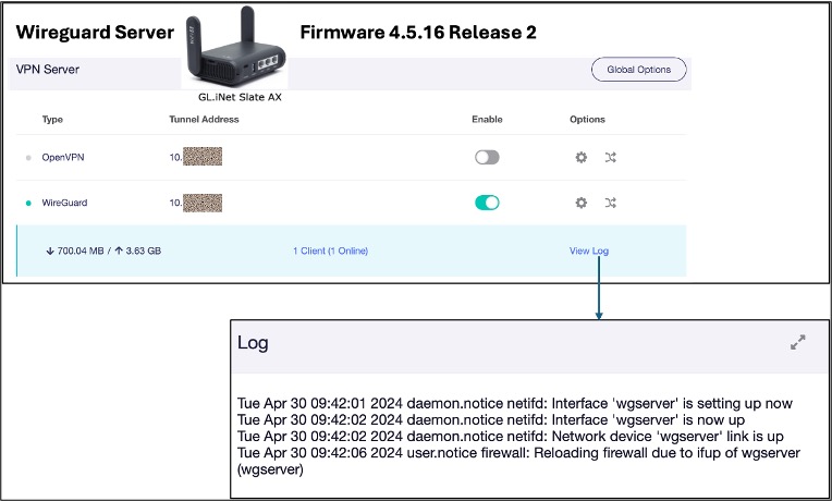

High level setup (details in attached pics):
2 x Slate AX routers
1 - configured as a wireguard server
1 - configured as a wireguard client -or- OpenVPN using PIA
Both are connected directly to HFC cablemodems via ethernet
Problem: when running wireguard site-to-site my speeds are really slow. when running as OpenVPN speeds are very fast (relative to my 100Mpbs internet service in that location).
I’ve tried many MTU settings ranging from 1280 - 1420. With different settings the download speed varies between ~10 - 20Mbps. What else can I try?

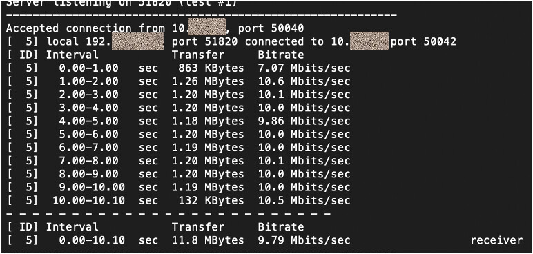

I was able to install/run iperf3 initially. However, when trying to rerun with the config you recommended I receive an error (address in use).
Now use the same command line on the client with the -R flag as well and post the output. Try to vary the -b value some until you see consistent dropped packets.
Worth noting that my current speeds are even lower than the original (0.46Mpbs down) and jitter went from < 10ms to 80ms:
  1. UDP Test: Unable to execute due to error (same message is in client and server log)
    Error text from log: iperf3: error - unable to start stream listener: Address in use
  2. -R variation does work but I need clarification on dropped packets (how to interpret the log). There are no apparent dropped values:
Sorry, I missed that you specified a port previously. You need iperf on the server and client side. I see you tried to assign that to the same port as wireguard. You need to use a different port, or stop the wireguard server and client before running this test. You should be able to use the default port for iperf3 and just drop the -p argument.
So on the server side, iperf3 -s and the client side iperf3 -c ip.addr -b100M -R and same without -R. That tests both directions to and from the client.
