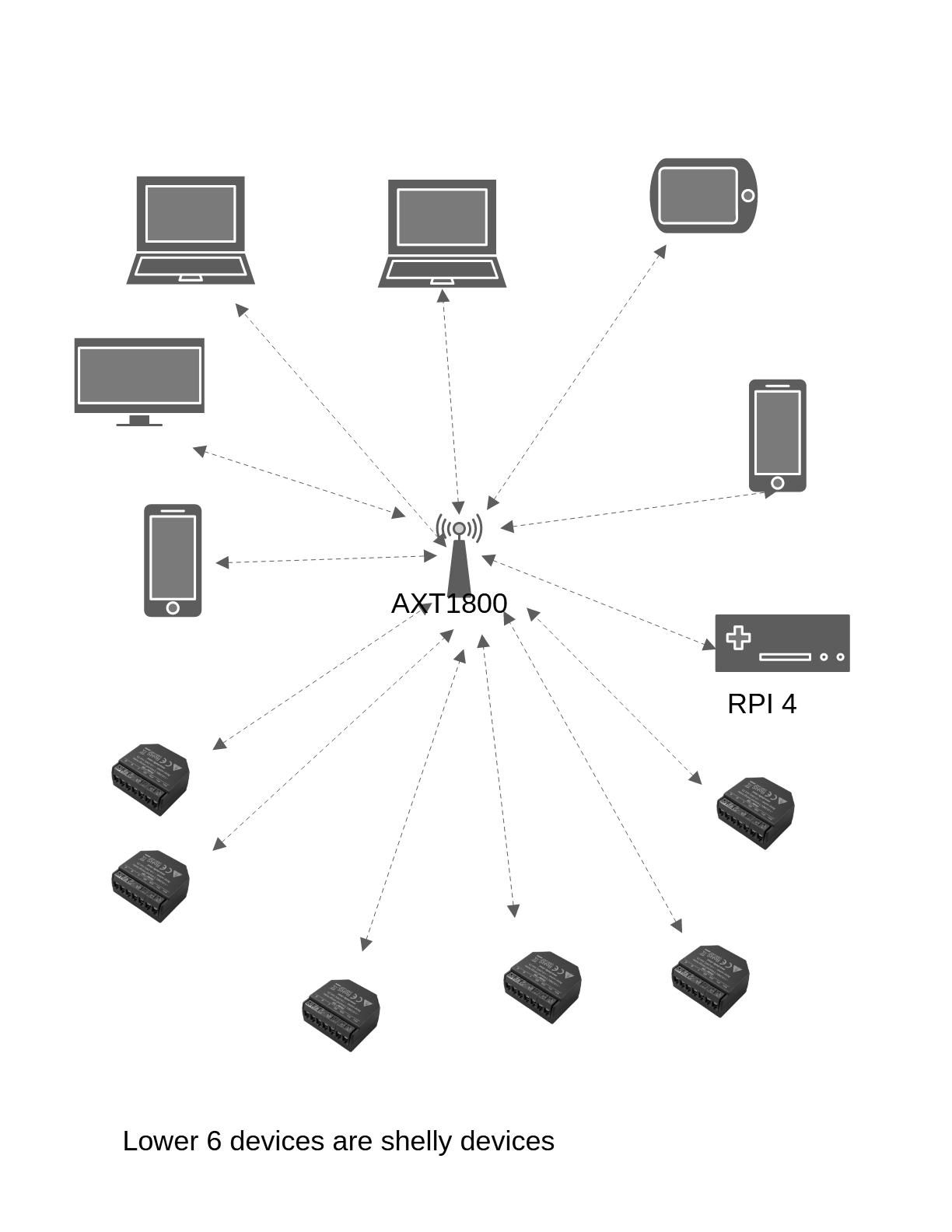

Hi @MustardSeed
  1. Could you please let me know the network topology image?
  2. Please share the configuration with us, export from Luci > System > Backup/Flash Firmware.
  3. Please let me know the MAC of Android tablet.
  4. Is the AXT1800 Wi-Fi SSID of 2.4GHz and 5GHz same one?

I just would like to know your issue about these:
  1. Network topology image
  2. Configuration
  3. Is the AXT1800 Wi-Fi SSID of 2.4GHz and 5GHz same one?
The 1800 is always in repeater mode. All connections are wireless.
When the issue was happening I tried with ssids as the same and different. The issue was seen in both cases. Now running 4.6.4 both SSIDs are the same and it is running fine.
I hope I have answered all your questions. Let me know if you need more.
