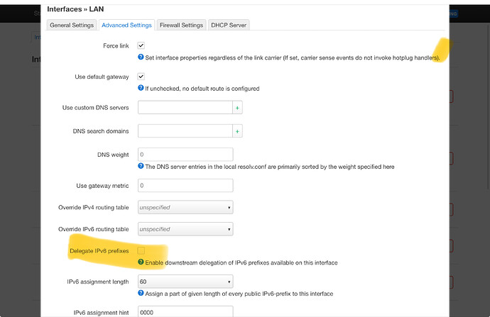

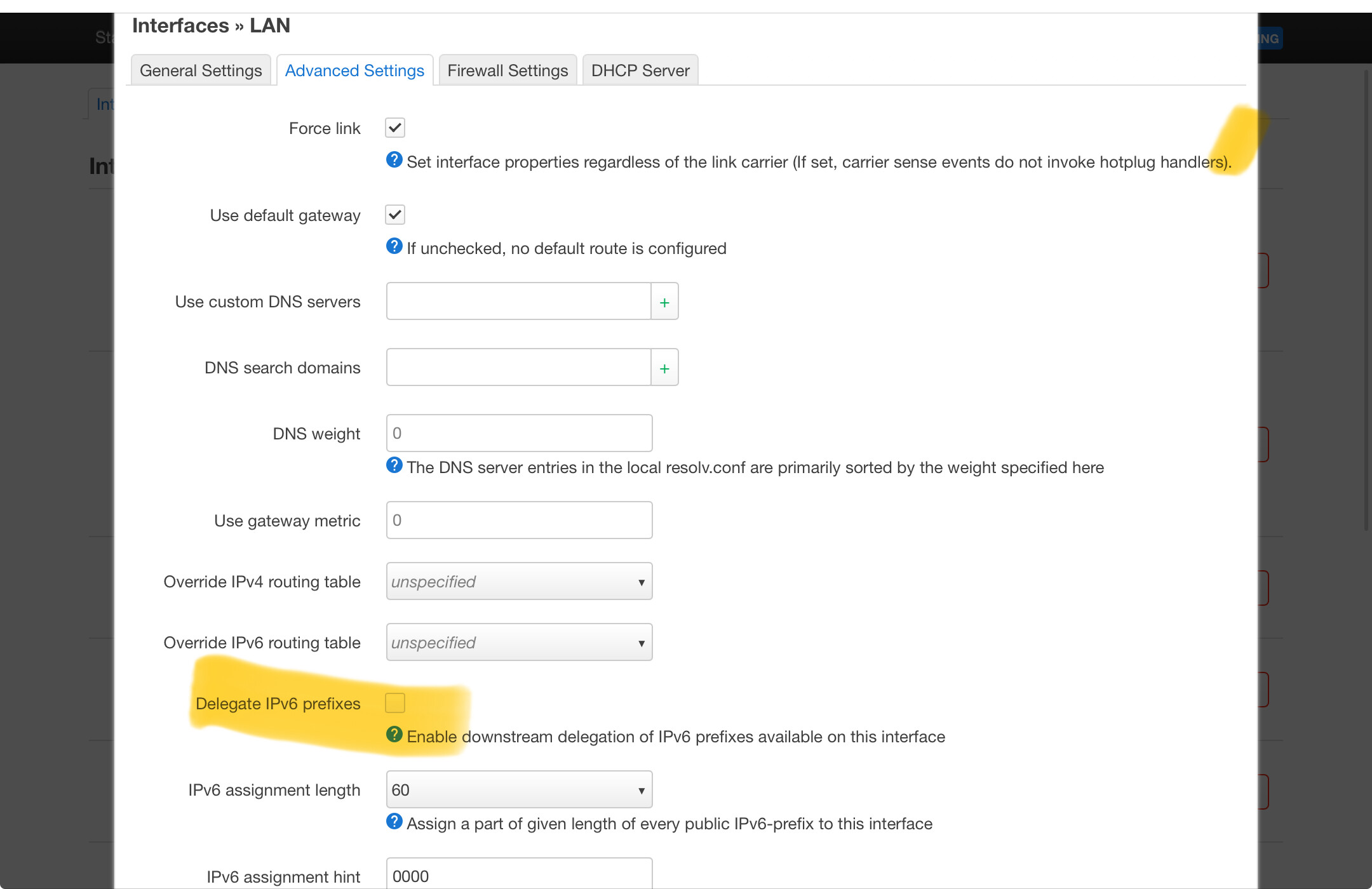

This is good to know, my work around in 4.8.2 was to disable IPv6 in luci config on LAN interface but now time to update 4.8.3 by the sounds
