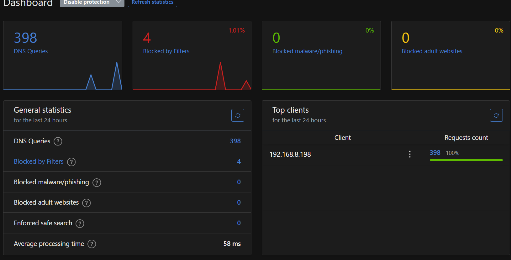

I have a Slate 7 that has worked just fine up until now. I am on the current firmware (4.8.3) and up until this morning, had Adguard Home, Tailscale and Mullvad all working fine. However, I had been looking through my router setup (curiosity) and found that Adguard had stopped listing any and all queries. I saw that there had been issues with some users in the past, so after trying a few things, I reset the router using “reset firmware” under “System” and re-setup the router. I didn’t bother installing Tailscale, nor Mullvad as both are installed on my various devices anyway, and only installed Adguard on the router. Now, I see that there are entries but still very little in the way of blocking.
This is certainly not the end of the world as I am able to run other adblockers on each device, but I am curious as to what I may have done to cause this in the first place.
Looks like guard is working, what is the exact problem? Do you need to have more blocklists or do some devices show ads?
I clicked the “AdGuard Home Handle Client Requests” toggle to off then back on and it pooched whatever was listed in the Query log, so I will have to wait until tomorrow to see if anything shows up.

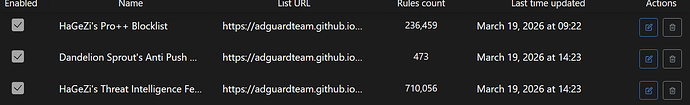

These are my block lists:

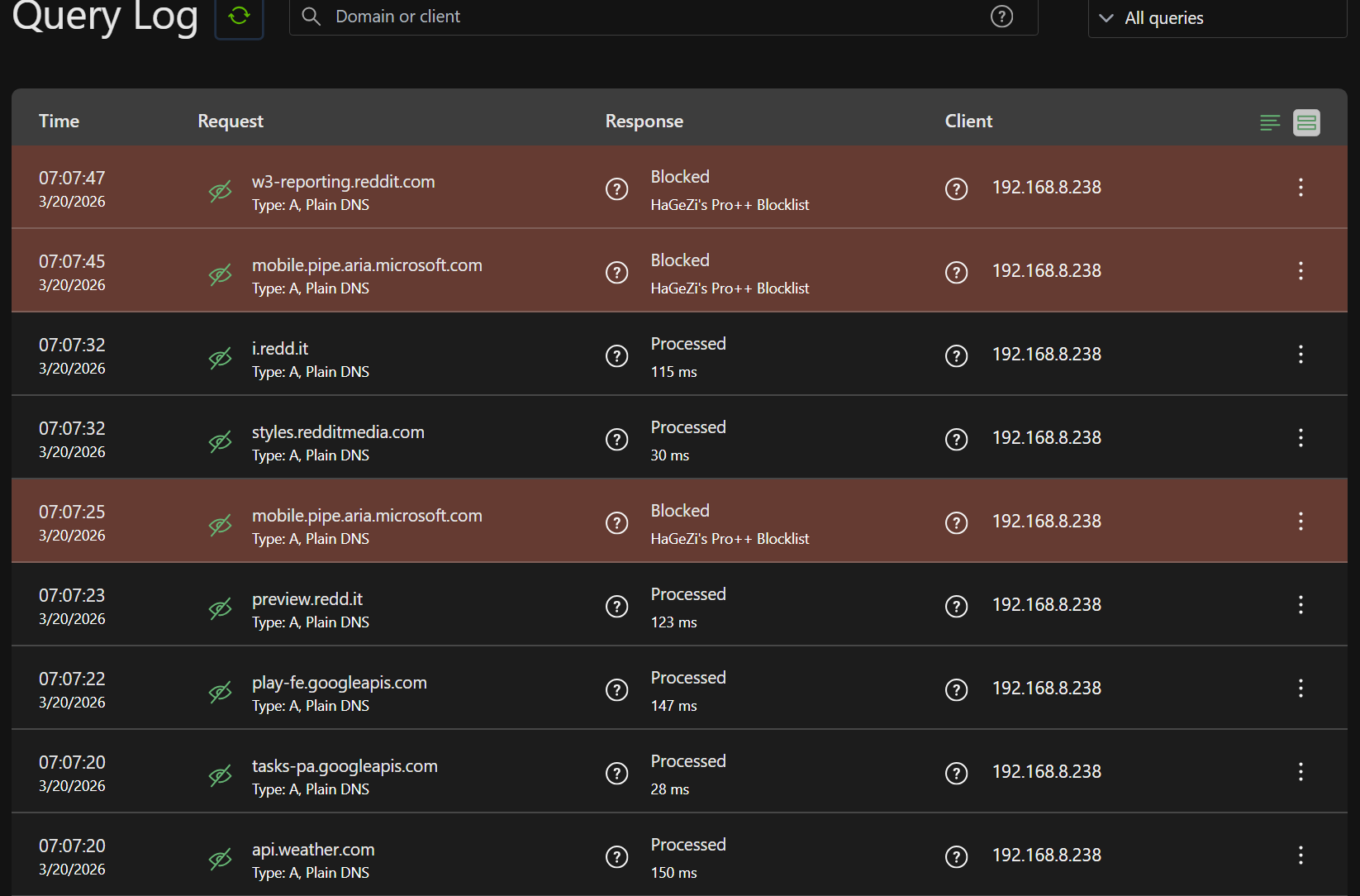

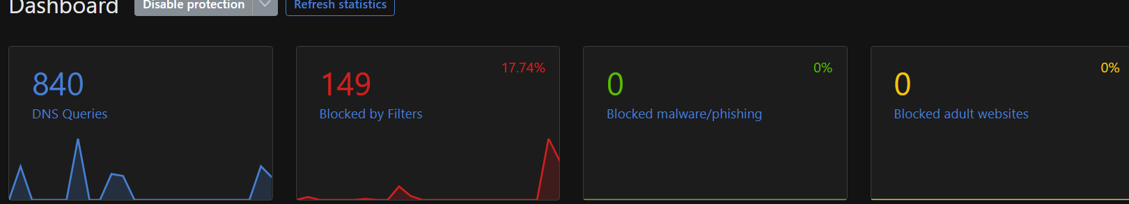

Not sure what I’ve done but (at the moment) it appears to be working. I normally use a windows 11 computer and probably have several security programs that may be interfering with whatever gets logged in the router. I tried my Samsung phone (I normally use the wifi on my Flint 2 but switched over to the Slate7) and got pages of logged info, as well as blocking being listed.
So I’m not too concerned about this issue with my windows computer (I’ll check my linux computers later) and will mark this as “solved”, at least until I invariably break something else.
