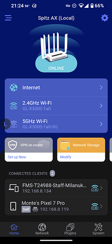

So… Spitz AX GL-X3000, showing firmware 4.0 - though I understand it displays that for certification reasons? I think it’s actually on 4.3.5. Trying to install 4.4.6, but running into some road blocks.
From the phone app, it all proceeds like it’s working fine, the progress indicator reaches 100% and… nothing. Just sits there. I tap ‘Close’ to back out, and I’m still back on 4.3.5.

2.4.9(188), shows a release date of 2024-04-07
