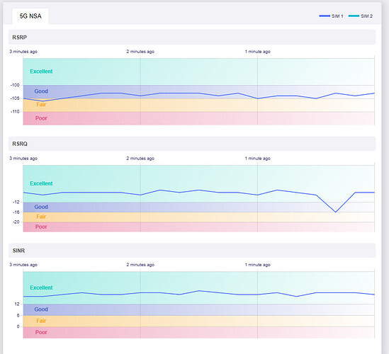

Ok, had some time to look at this more.
Made a profile with only LTE band 66 & 5G NSA band n5.
BOOM! 5G displayed in WebUI & signal history as you would expect. Seems to be a GUI error of only reporting 4G+ on Verizon since they apparently need the LTE anchor to register the SIM? It seems like Verizon requires an LTE connection to then get a 5G connection.
Maybe a router firmware update could correct this?
+QCAINFO: “PCC”,66836,50,“LTE BAND 66”,1,65,-102,-8,-77,16
+QCAINFO: “SCC”,66536,100,“LTE BAND 66”,1,65,-101,-8,-84,14,0,-,-
+QCAINFO: “SCC”,174290,1,“NR5G BAND 5”,65
OK
5G NSA registration is required through LTE first
