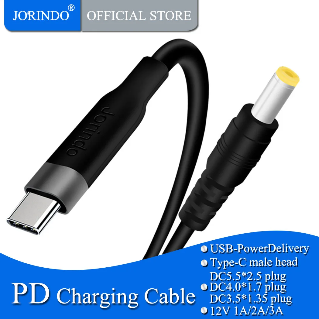

A better option is to get a USB-C PD Powerbank that can output 12v on the USB-C port, then use a trigger like this:
https://www.aliexpress.com/item/1005001546335966.html
Great idea, thanks! I didn’t know this was an option. I’ll make a little adapter from one of these devices and find a USB-C PD battery bank to go along with it.
I use this combination for my X750v2 SPITZ. No fabricating required. DC4017
Voltage output is stable @ 12.1v, regardless of my battery voltage.
I understand the spitz will run at any normal 12v battery voltage - from 11.5v to 14.5v. So the Usb-C PD adapter plus 12v negotiation cable seems extraneous?
