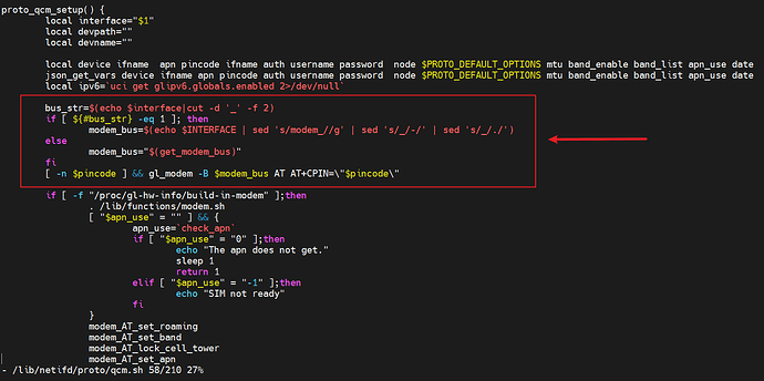

Hi,larrs110. If you are willing to adopt my solution, can you enter the x3000 terminal to modify this file? and set the pincode and redial in manual setup.see whether it works?
File path: /lib/netifd/proto/qcm.sh

Hi,larrs110,after modifying the file, use this manual setup to reconnect to the cellular network.See whether it works?

Hi,larrs110. use the root username
your highlighted section does not exist as you show it but further down under i/raw_ip and no option for pincodes. There are other pincode elements but I am not a code guy and better I let you look at the file.

Hi,larrs110. Have you added highlighted content to the file?Has the cellular network started working now?
Im sorry, but do you not read my replies ? I want to reiterate that this attempt to fix the cellular connection may yield a result but the router has several issues and the real fix is to have the firmware reinstalled, possibly to an earlier stable version. There has to be a workaround for this and again I beg the question. Going back to the amended file, are you working on a different version, not 4.4.6 as the file I sent you does not compare directly ?
If it is convenient for you,you could share with gl.inet_support via cloud platform.I will check it remotly.
Looks like there is miscomms between you two. @YQ24 wants you to ADD the highlighted area to the code, not modify the pincode var in the highlighted block. But yeah would be better if the highlighted code was being copy pasted into here instead taking a screenshot…
OK. Thx spitzuser. I did exactly that and replaced the pincode variable with the pin number, and it did not work. But I am not a coder so the chances of me creating that section and getting it right are slim. I hit reset firmware in system, Delete & Reboot once again so I am back to square one. Please someone please advise. Again I ask, is there a way in Luci for me to download and reinstall a more stable version like say 4.4.3 ?
Don’t change the variables. Only place the highlighted code between the lines.
local ipv6=uci get glipv6.globals.enabled 2>/dev/null
HERE
if [ -f “/proc/gl-hw-info/build-in-modem” ];then
Save file and enter your PIN in the GUI.
You can download 4.4.3 from GL.iNet download center and do a downgrade via GUI, like shown above in RVer’s reply
