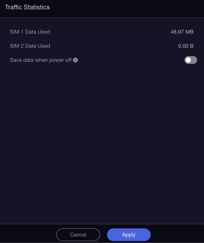

Wanted to ask if there’s a way to schedule a reset of the cellular data counter, like on a monthly bases when the allotted quota renews?
If not, then how to manually reset it (other than rebooting)?

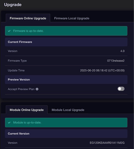

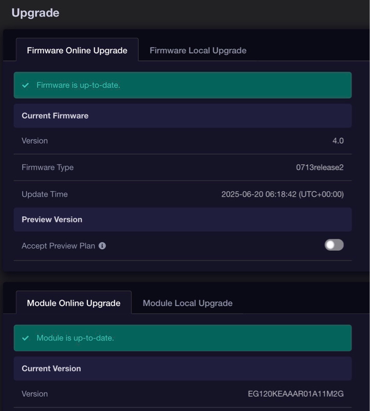

Thank you @bruce for your reply. Unfortunately, I don’t see those options on my Spitz Plus. Is this on a beta release?
bruce
August 21, 2025, 6:20am
5
Sorry, probably the v4.8.x firmware is supported, and X2000 needs to wait a while for the v4.8 firmware.
In v4.7, there is no other way to reset the data statistics except the method you mentioned.

A way was found, which can be executed these commands in SSH to clear the counter in v4.7 and below:
echo 0 > /etc/gl_modem_traffic/traffic_sim1
echo 0 > /etc/gl_modem_traffic/traffic_sim2
echo 0 > /tmp/traffic_sim1
echo 0 > /tmp/traffic_sim2

Fantastic! I’ll crontab this and reset monthly according to my data plan. Thank you for following up @bruce .
