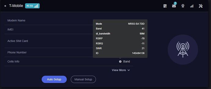

I have 5GSA in my location. I am only 1 mile from tower.
But every time X3000 boots up, i get 4G+ or 4G connection.
