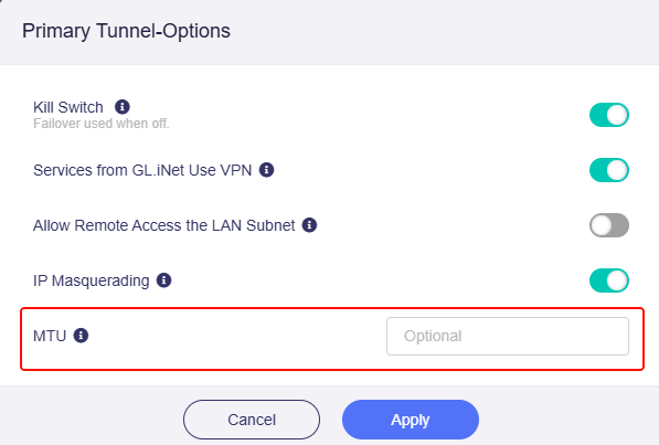

Try manually entering a MTU for Spitz's WG client, such as 1380 or smaller.
And enable the IP Masquerading too.
