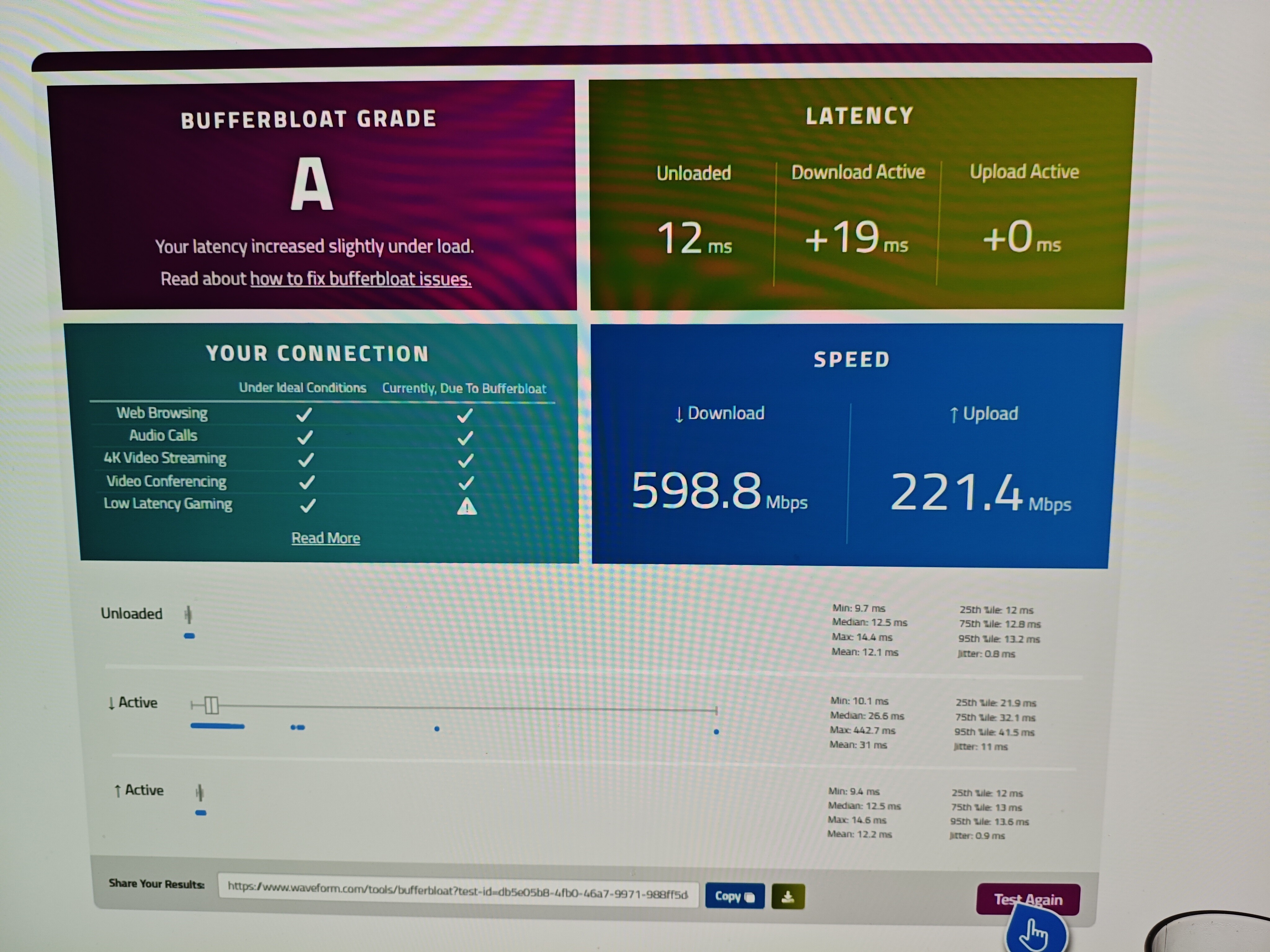

I have a Flint 2 router and a 1 Gbps/300 Mbps connection.
I have SQM installed; it works fine on my PC, but unfortunately it doesn't work on the Xbox Series X. I've tried everything—changing LAN ports, cables, various SQM settings, and different speeds—but the result is always the same: it doesn't work on the Xbox.

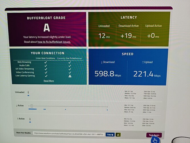

“When you say it doesn’t work do you mean upload or download or both?”
In my opinion, it looks like the download isn't working—look at the photo: an extra 19 ms, and in the “active” section, a jump to 442 ms.

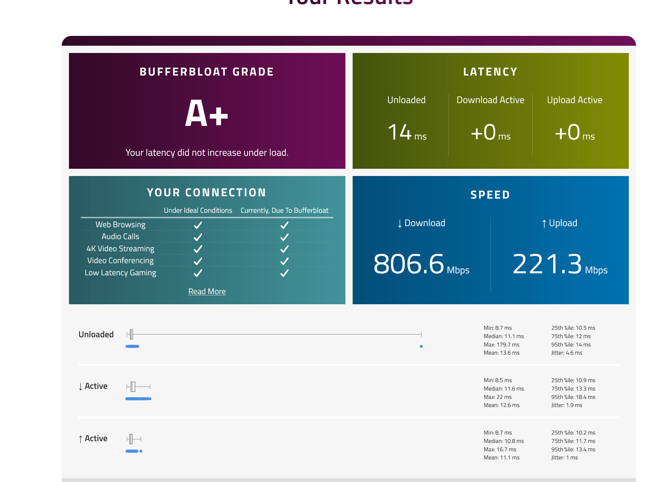

Test on PC

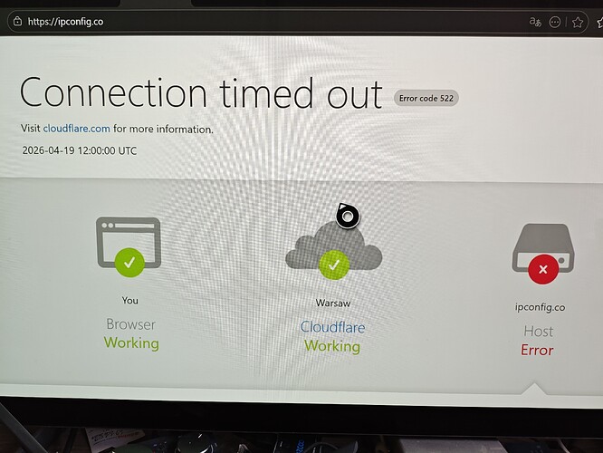

If you visit ifconfig.co on both browsers do they show the same public IP address? (Not sure how browsing on Xbox works and if they add some kind of security layer in the browser that may alter the results in this test)
On PC i see public IP but on Xbox i can`d do it this test. i check on “ifconfigme” and I see public Ip on Xbox.
Typo in the screenshot. It is trying ipconfig.co and not ifconfig.co
whichever tool you use important thing is the public ip shown is the same for both devices?
Yes, that is correct. Both devices with public IP.
Sorry, I presume you mean it’s the same IP for both but just want to be certain as it’s is ambiguous in the way you are writing the messages. Both have the same public IP?
So both devices have the same public IP address from the ISP

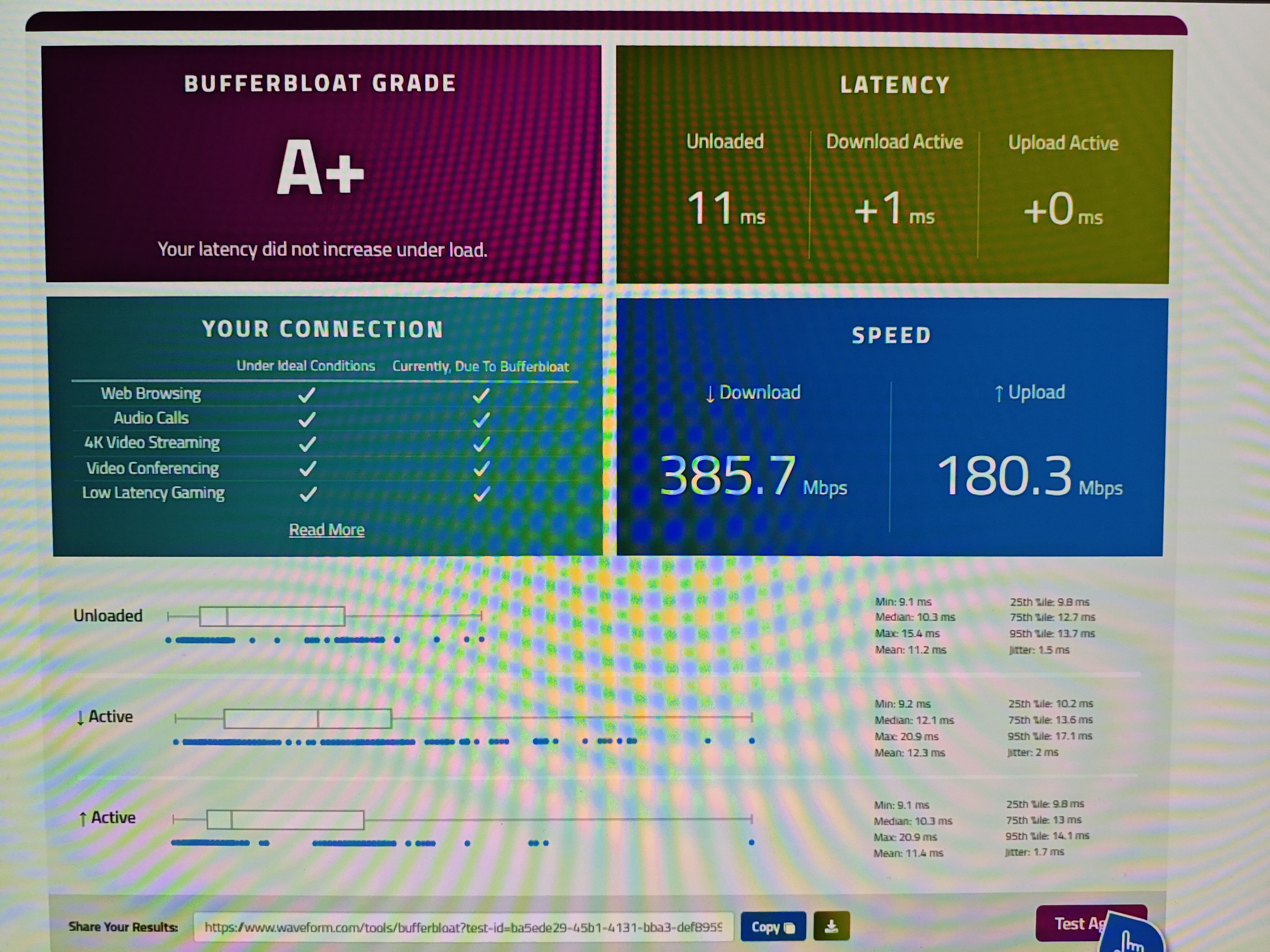

I understand what you're saying; I also have an old Netduma R3 router with QoS. Below is a test from the Netduma—please note the “Active” section and compare it with the test a few posts above (from Xbox).
It looks like this latest one has the bandwidth clamped down much further - 385 vs 598 on the Flint.. so you’ve traded less “bufferbloat” at the expense of a 30% reduction in your bandwidth.

@PawelP - your ping test is the real sign. 8ms>26ms during Xbox saturation privdes an 18ms delta. Waveform on Xbox reported +442ms for the same. Those don't agree. Waveforms own docs note the test intentionally saturates the connection "because that's a sure way to trigger bufferbloat visibility". This is an intentional adversarial test (artificially created), not normal use. The 18ms your PC measured is the number of substance. Games don't push the link like a speed test does, so in-game you'll sit well under that.
