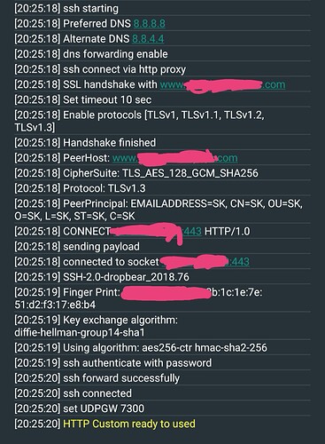

Is possible connect to internet via SSH tunnel (router Brume + 4G modem Huawei e3372)?
this screenshot is on my mobile ussing app HTTP custom… and work perfect…
