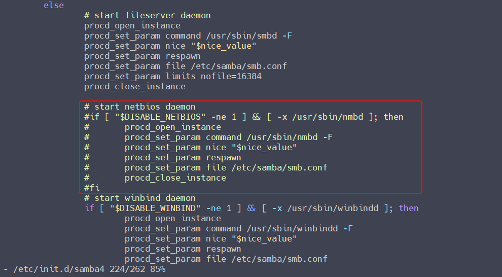

I also tried manually samba4.@samba[0].disable_netbios='1' and manually remove the comment about disable netbios in samba configuration,
cat /etc/samba/smb.conf.template | grep "disable netbios"
        disable netbios = yes
cat /etc/samba/smb.conf | grep "disable netbios"
None of the above configurations can disable netbios.
But when I try to comment out the netbios daemon in start script of samba4, I found the netbios is disabled, no 137 and 138 ports listening, and without affecting samba.
root@GL-AX1800:~# netstat -tunl | grep 137
root@GL-AX1800:~# netstat -tunl | grep 138
root@GL-AX1800:~# netstat -tunl | grep 445
tcp        0      0 0.0.0.0:445             0.0.0.0:*               LISTEN
tcp        0      0 :::445                  :::*                    LISTEN
You can have a try.
