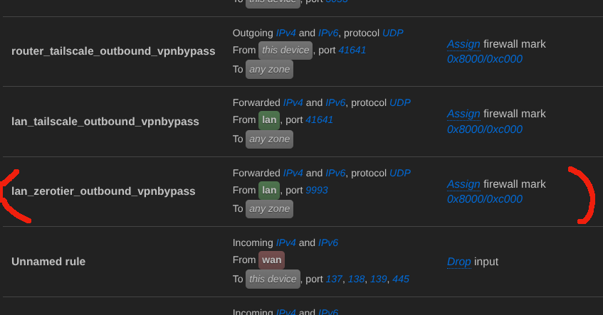

I added a VPN bypass rule on my Beryl AX (used with my laptop on the road) and my Slate AX at home. These rules look like the following (screenshot includes a couple adjacent rules for comparison):

Is my VPN bypass rule incomplete? Maybe ZeroTier is sending some other traffic which isn’t covered by that firewall rule, and so some traffic is going thru the VPN and some not?

Your guess is correct.
ZeroTier doesn’t only use 9993 as the source port (primaryPort); it also uses random secondaryPort and tertiaryPort.
Maybe you could try creating or modifying ZeroTier’s configuration to make it fixed, and then mark it accordingly in the router’s firewall.
