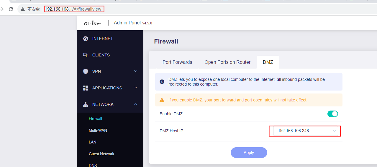

Does the topology shown below(picture 1) match your case? And PC behind USG can not access server behind Alien?
1.Make sure access from WAN is accepted on Alien, which can be confirmed by ping 192.168.8.142 from PC behind USG;
2.Expose Server behind Alien via port forwarding or DMZ on Alien.In my case, I setup a web server on 192.168.108.248 with port 8080, and enable DMZ on it as shown on picture 2.
3.Access Server behind Alien from PC behind USG via WAN IP of Alien, as shown on picture 3.
