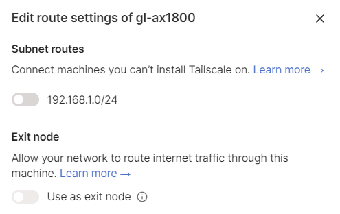

Oh I see what you mean - in the web interface for Tailscale…
Ah, no idea what that means but…
Its the only device in the Tailscale network that says has unapproved routes…
I tried enabling 192.168.1.0/24 in that menu - and disabling it - made no difference - still cannot connect to the GL_iNet front panel (port 80 default) - progress bar on my phone only goes in about 20%… no further
You need to approve this route to access the router’s local subnet. Without this, it is impossible to get into the web interface of the router!
Ok, so I’ve now gone in and approved it… no difference… and no I cant seem to access the admin panel locally (192.168.1.1)… something very wrong here - if I go and disable that subnet setting - I can once again access my GL-iNET control panel locally as 192.168.1.1 - if I enable it, I lose local browser access to the control panel - but not it seems, the Internet… any thoughts?

I also checked on TailScale -
and tried turning that subnet setting on and off again, either way the EXIT node stayed grey.
