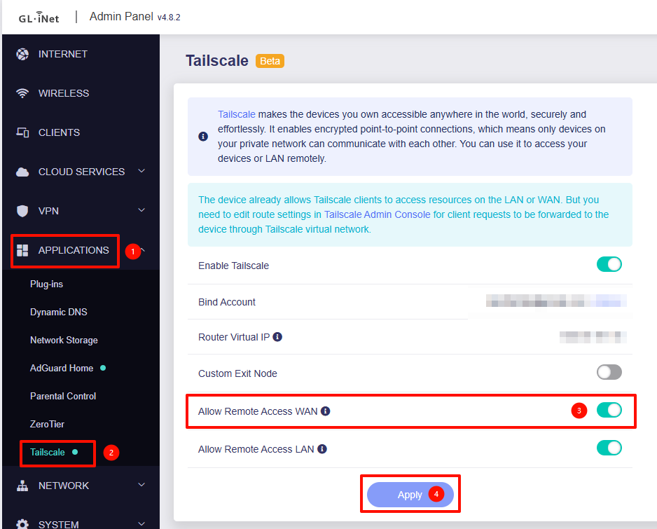

Remember to enable the "Allow Remote Access WAN" to allow forward from Tailscale to WAN.

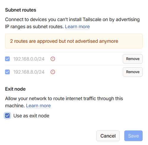

Thanks. I was able to run that code and it worked, however, I am now getting the following message from Tailscale admin center
After a reboot it is advertising the exit node as well as the local LAN - so that is good. Strangely this morning from home I was on the Brume (connected through tailscale to the 6000) and even though tailscale admin showed the devices as online, I didnt have any internet so presumably something was happening on the 6000 that wasnt passing traffic.

  2. enabled "Allow Remote Access WAN"

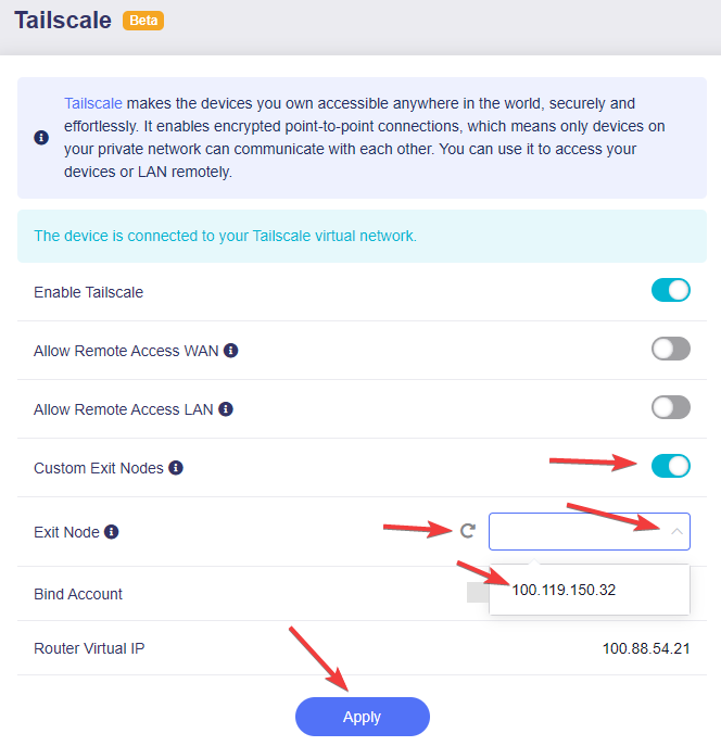

May we know have you configured the MT6000 as an exit node in Brume?
Tailscale - GL.iNet Router Docs 4
