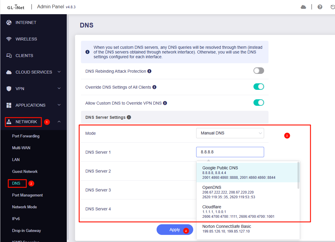

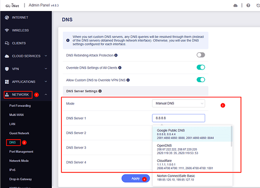

Please try selecting a functional DNS server in Admin Panel > Network > DNS and see if that resolves the issue.
Thank you! That worked
