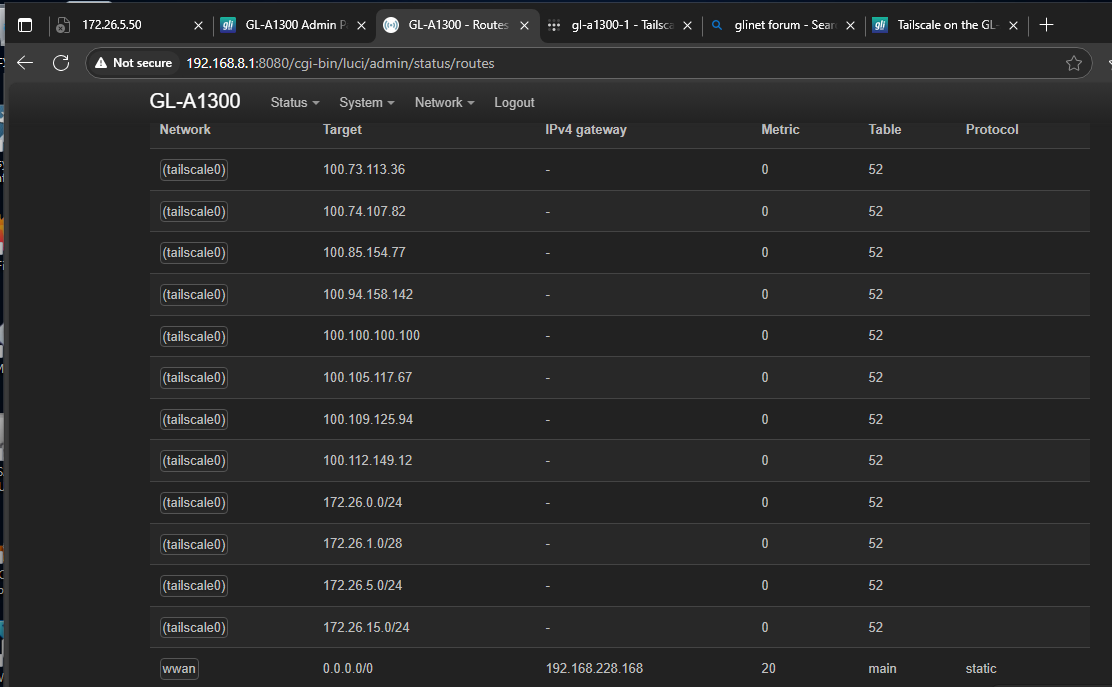

I have been working on this again today. I have checked the routing table (screen shot below) and it shows correct from what I can tell via the LuCI interface.
Still if I try and ping from a client device a device on the 172.26.5.0 subnet I do not get a response. However if I do the same from the Routers SSH Command line i get a response.
Any other pointers are welcome, I can't find anything int he firewall to allow traffic to pass to the tailscale network so is this the problem?
