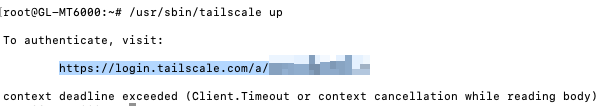

Symptom: when I am trying to bring up tailscale (starting tailscaled), it seems (on the web interface) as if it came up, but it keeps flicking off then on again.
At this point, after a lot of troubleshooting and steps that I took to try and fix it, it now flicks up the warning that I need to follow the link to authorise the device, but clicking on the link gives an error message - this is fully understandable because when I look in the logs it is clear that the tailscale daemon never comes up fully and just tries again every 3 seconds.
A relevant section of the log is below:

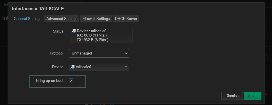

  • I have looked at LUCI and compared the setup with a Flint 7, which is not a full match of course, and the tailscale device is actually up on the flint 7, but the only thing I could really see that was weird is that flint 7 has a tailscale0 device, whereas flint 6 has a tailscale interface (but no device). I have also manually set up a zone in the firewall on flint6 to be the same as flint 7 - just after suspecting the issue may be related to firewall (but I know the gl_tailscale script does play with firewall rules to a degree).

If you run tailscale login does it work then?
nope - tailscaled is not running.
What I can do, and I did it now again:
  • Login and run tailscaled interactively:
/usr/sbin/tailscaled --verbose=3 --state=/etc/tailscale/tailscaled.state --port=41641
  • On a separate terminal, run tailscale up. This gives me the authentication link:
  • I can follow the link and authenticate the device. The tailscale console now shows the device as online. I can also ping the device over the tailscale network.
If at this point I exit the SSH connections, and go back to using the web UI, trying to switch on Tailscale, we get basically the same behaviour.
The status row constantly says “connecting”, I get the amber “dot” next to the Tailscale app. The page shows that the machine is bound to my account now, but in the logs I have the exact same loop showing connection-disconnection-connection-disconnection happening.
I have been here before in my troubleshooting attempts, next I was removing the machine from the tailscale console, cleared the state, where we got back to the device authentication attempts with the same connection-disconnection loop. Which is again why I suspect this is not specifically to do with the tailscale version or the core tailscale implementation itself, rather something to do with the GLinet port/implementation/wrapper.

You can try editing it and disabling the “Bring up on boot” option to see whether this fixes the issue of the interface repeatedly coming up again after a reboot.
We more strongly recommend deleting the Tailscale interface that was manually created in LuCI → Network in the previous version.
As you mentioned, the firmware now automatically creates the tailscale0 device and the corresponding firewall zone when the Tailscale feature is enabled, and automatically adds the device to the firewall zone, so manual creation is no longer necessary.
Since this setup is configured through LuCI, and we are unable to account for all possible scenarios that may exist in LuCI, thanks for your understanding.
OK thanks for that @will.qiu
Deleting the tailscale interface and firewall zone worked great.
