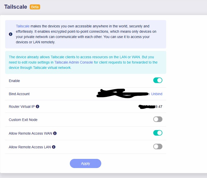

I have enabled Allow Remote Access (WAN) and approved the subnets in the Tailscale management interface. I can see two entries there: my local IP range and the IP address from my ISP.

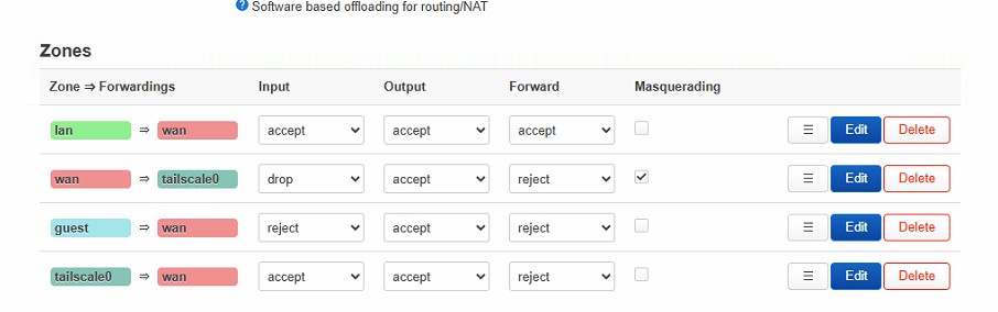

I also briefly checked the firewall, but I'm not sure if anything needs to be changed there, since the router automatically activates the Tailscale rules on its own.

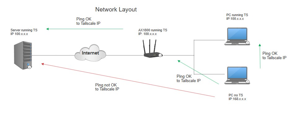

Could you draw a simple network topology including IP addresses (including Tailscale IPs) so we can better understand your setup?
If your server needs to be accessed via the Tailscale network, and devices without Tailscale are connected to the AX1800 via LAN, then you should enable “Allow Remote Access LAN” and approve the LAN route in the Tailscale Console.

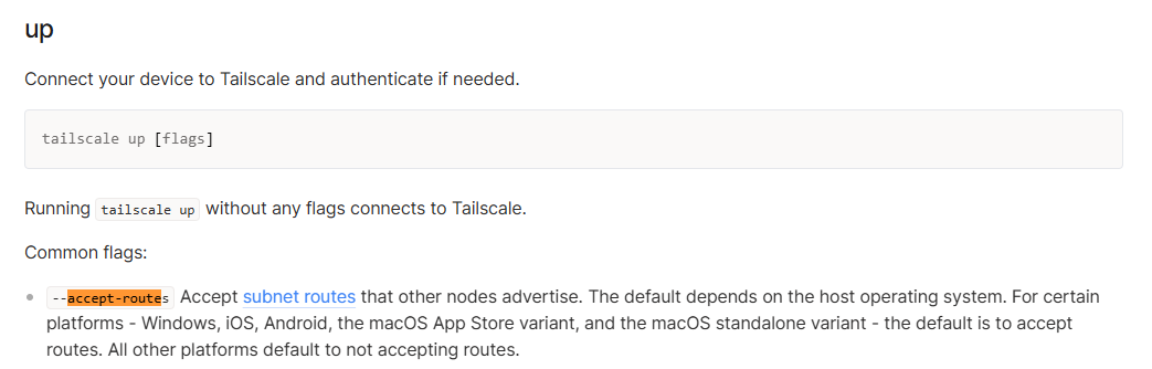

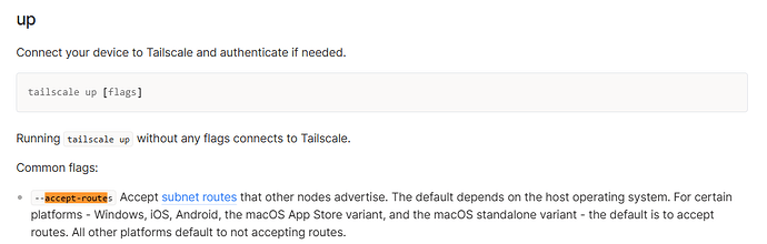

Also, please make sure that Tailscale on the server is running with the --accept-routes parameter, so it can correctly route requests to LAN devices:
Reference: Tailscale CLI · Tailscale Docs
Please see below.
