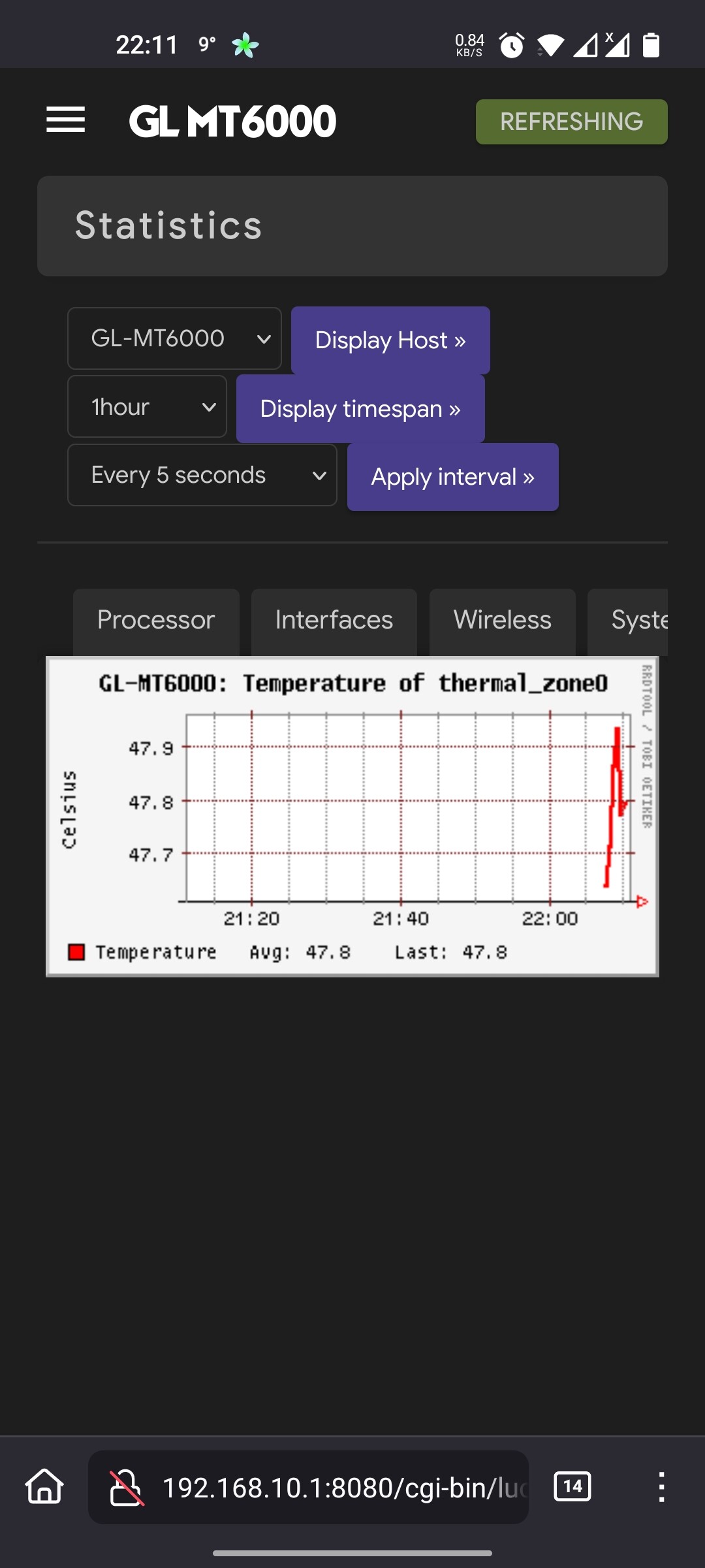

Hello guys. Is this a normal temperature for Flint2? Also not a lot of traffic when i have made the screenshot.
55°C is quite good and normal for a device whitout any fan...
Thanks for the info. normally i am used with 30 degrees temps in my devices that why i was a bit curious to ask

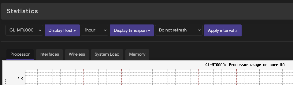

Hey, can you tell how exactly you add temp monitor? I try use it but cant setup it correctly, its don't show in my menu.
I had to install collectd-mod-thermal in order to get the Thermal tab to show up, but I also cannot get the same graphs as the OP shows... I am also curious about this.
Thanks! It's work. Why he don't tell about that thermald package.

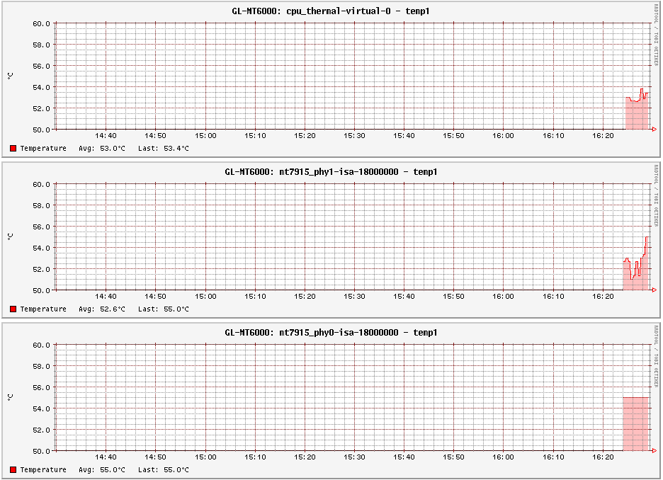

Don't show
You about this? Or how you show other screen in my thread?
I don't think OP is running the GL.Inet version of OpenWRT, those sensors don't appear in the /sys/class/thermal tree nor in /sys/class/ieee80211/phy on my Flint2 running 4.7.4 (OpenWrt 21.02-SNAPSHOT r15812+1083-46b6ee7ffc)
