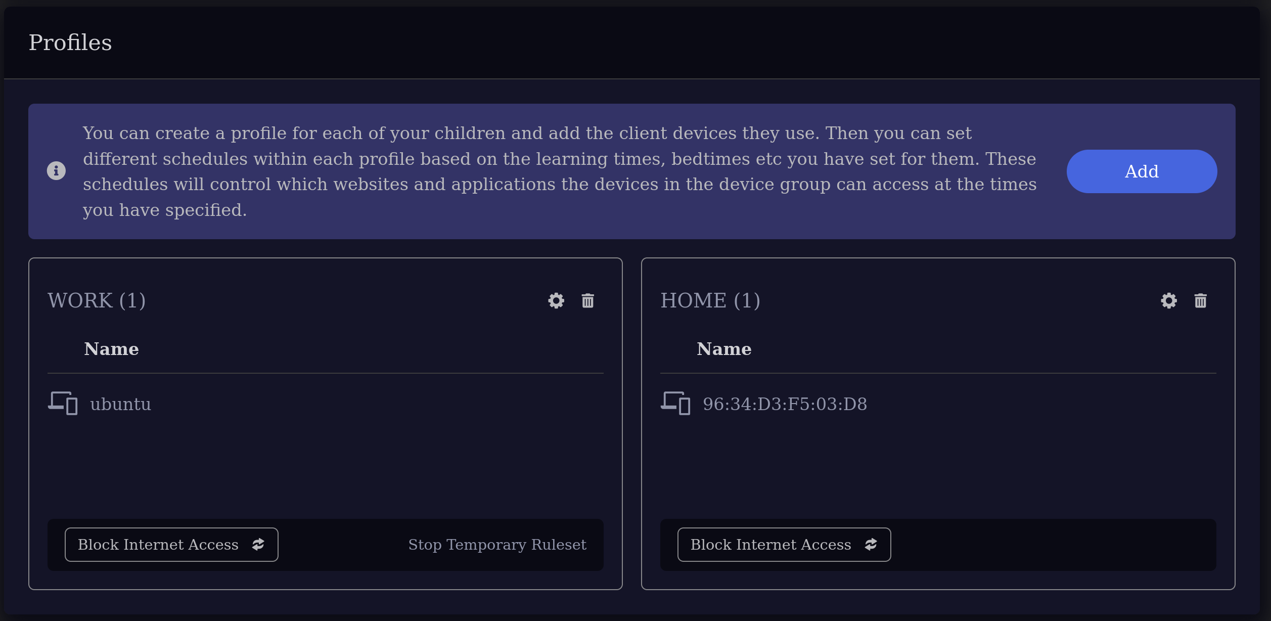

Can you give me an example of a parental rule that you want to disable ? Perhaps with screenshot .
It's just a profile for work to only allow company devices to have internet access during work hours.
The problem is that sometimes I need to use the laptop after work hours and going to the router page or app and temporarily enabling a ruleset to allow internet connection takes too much time.
Here's an example screenshot:

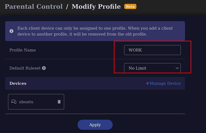

I created two different profiles on my modem as follow:
             ~~ EXECUTING CURL FROM ANOTHER SYSTEM ~~~
Each defined profile (e.g. WORK, HOME ...etc) within the internal system is named as groupxxxxxxx. To fetch all profiles execute this curl command after replacing the SID string below with your valid SID:

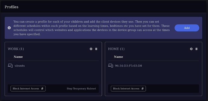

As you can see from the HTTP response above, I have two group strings: group2129416 and group7342748. These groups correspond to the WORK and HOME profiles that I defined.
Now let's say I want to ALLOW/BLOCK the internet access for my WORK profile (group7342748), I just need to set the enable key from true to false and vice versa:
