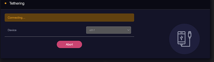

After restarting the GL-SFT1200, the tethering state of the 4G modem Huawei e3272 is connecting. When I click abort and connect button it started to work.
How can I get the modem to work after a reboot without going into the GUI?

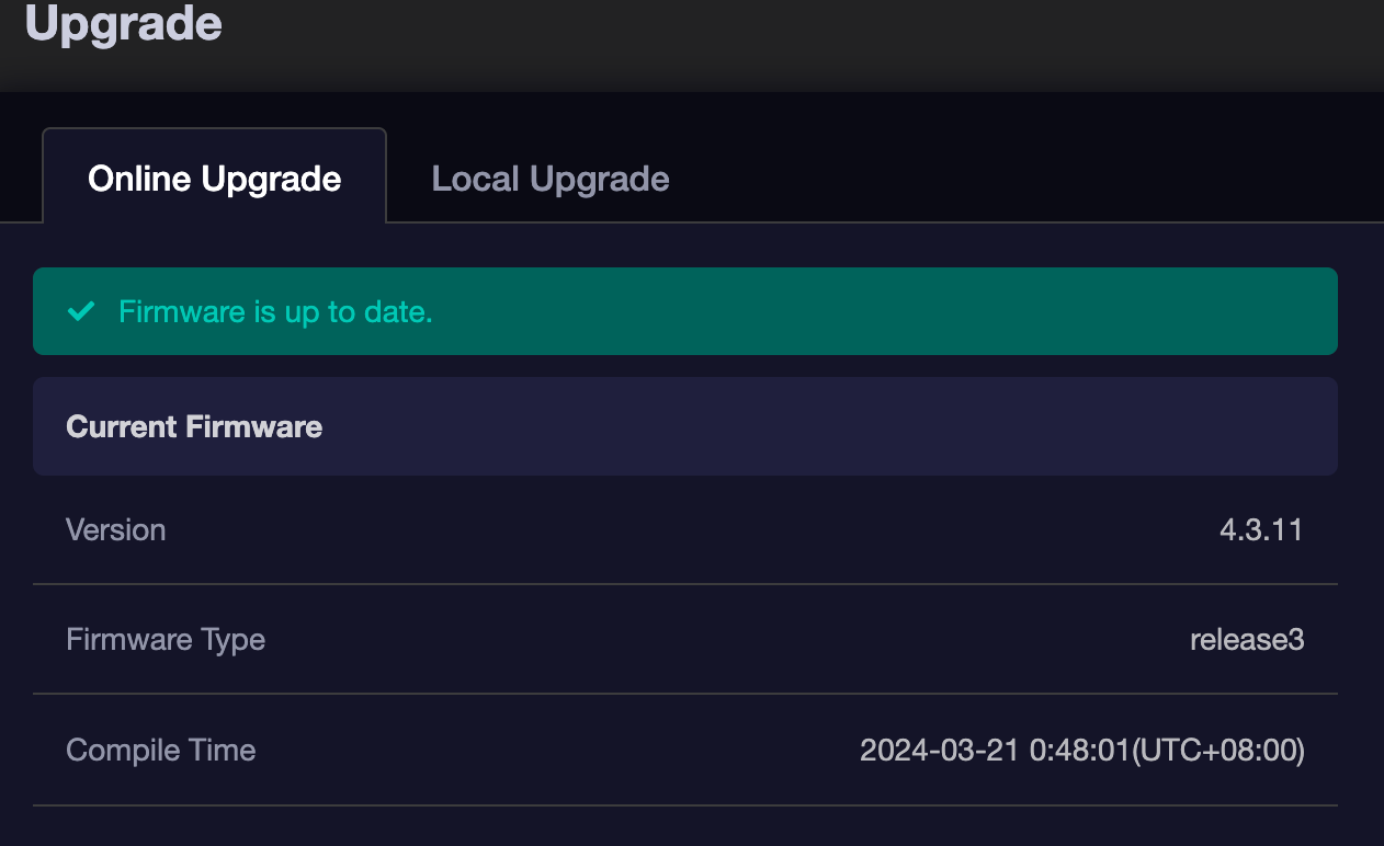

what firmware version are you using?
4.3.11
Hello,confirm that the firmware has this issue, the next version will fix this issue.
