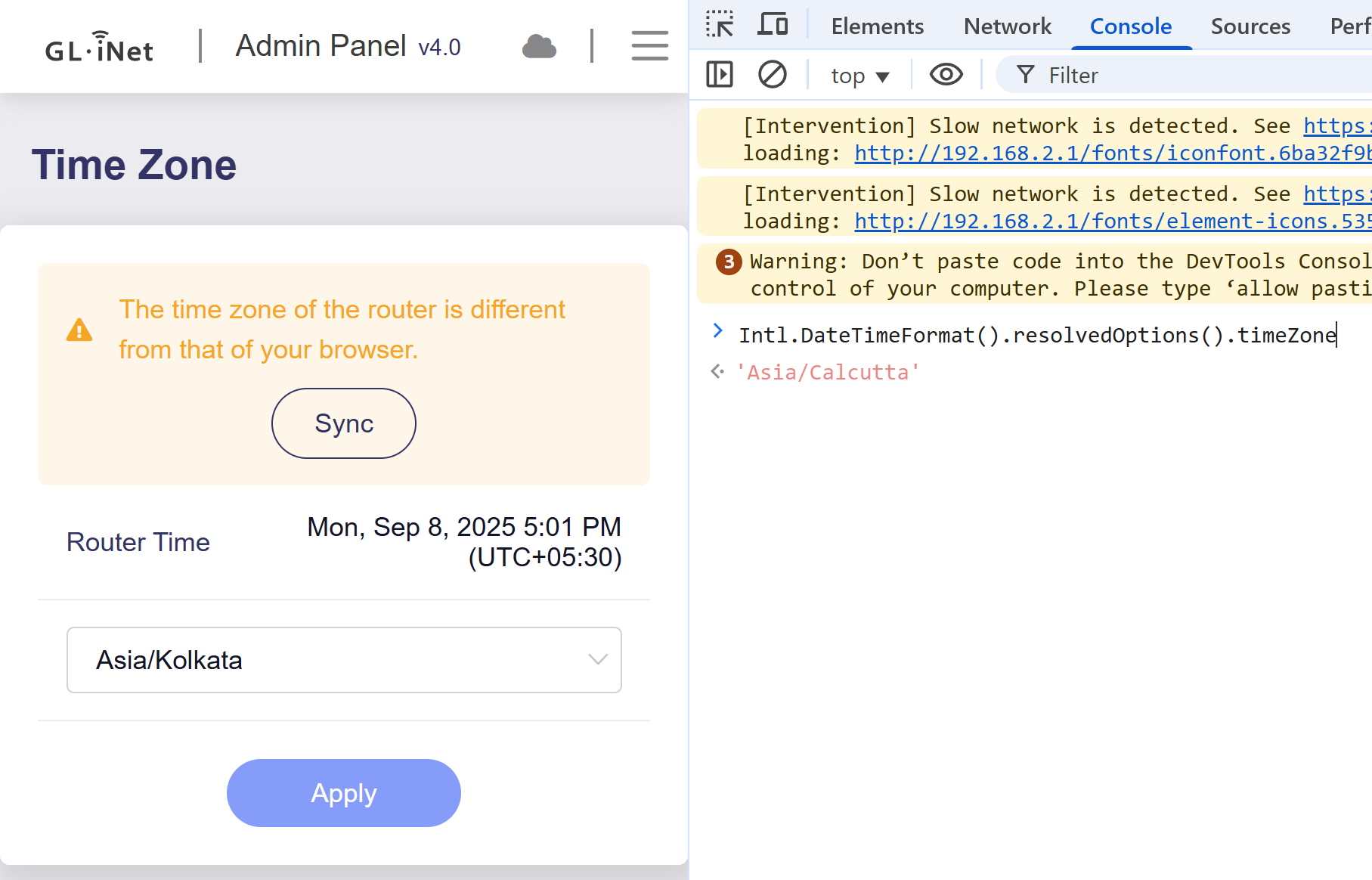

How? tell me please.. having same problem for “Asia/Kolkata”
still same problem with latest Beta firmware for “Asia/Kolkata”.

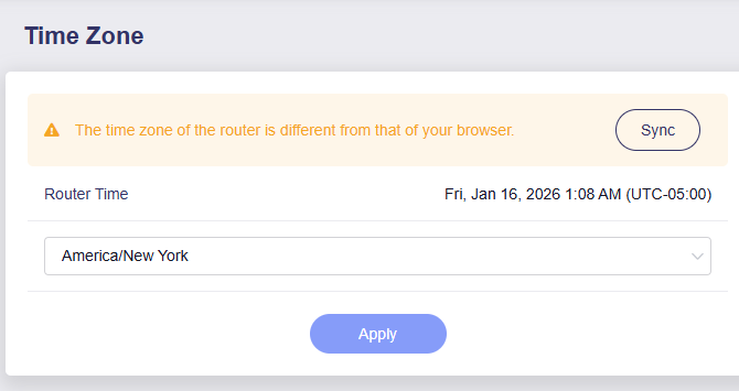

having the same issue with america/new york
