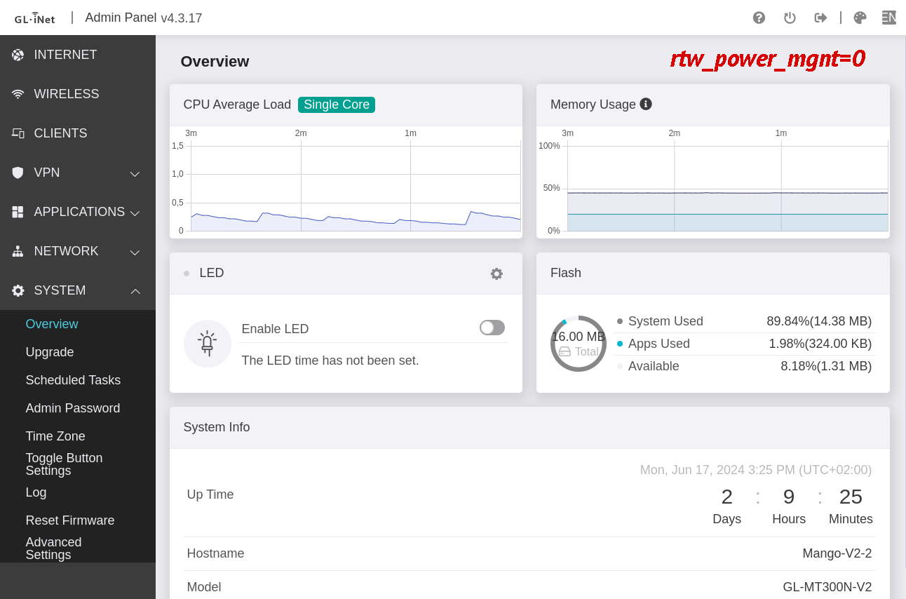

Laptop (Debian stable):
Intel Corporation Wi-Fi 6 AX201
USB: TP-Link RTL8812AU Archer T4U 802.11ac (Driver: GitHub - morrownr/8812au-20210820: Linux Driver for USB WiFi Adapters that are based on the RTL8812AU Chipset - v5.13.6-23)
Short test with TP-Link RTL8812AU Archer T4U:
/etc/modprobe.d/8812au.conf
options 8812au rtw_switch_usb_mode=0 rtw_led_ctrl=1 rtw_power_mgnt=1 rtw_country_code=DE
options 8812au rtw_switch_usb_mode=0 rtw_led_ctrl=1 rtw_power_mgnt=0 rtw_country_code=DE
PING 192.168.118.1 (192.168.118.1) 56(84) bytes of data.
64 bytes from 192.168.118.1: icmp_seq=1 ttl=64 time=3.79 ms
64 bytes from 192.168.118.1: icmp_seq=2 ttl=64 time=4.16 ms
64 bytes from 192.168.118.1: icmp_seq=3 ttl=64 time=2.18 ms
64 bytes from 192.168.118.1: icmp_seq=4 ttl=64 time=2.45 ms
64 bytes from 192.168.118.1: icmp_seq=5 ttl=64 time=2.74 ms
64 bytes from 192.168.118.1: icmp_seq=6 ttl=64 time=9.82 ms
64 bytes from 192.168.118.1: icmp_seq=7 ttl=64 time=2.58 ms
64 bytes from 192.168.118.1: icmp_seq=8 ttl=64 time=2.13 ms
64 bytes from 192.168.118.1: icmp_seq=9 ttl=64 time=2.23 ms
64 bytes from 192.168.118.1: icmp_seq=10 ttl=64 time=2.12 ms
64 bytes from 192.168.118.1: icmp_seq=11 ttl=64 time=2.34 ms
64 bytes from 192.168.118.1: icmp_seq=12 ttl=64 time=2.61 ms
64 bytes from 192.168.118.1: icmp_seq=13 ttl=64 time=2.21 ms
64 bytes from 192.168.118.1: icmp_seq=14 ttl=64 time=2.58 ms
64 bytes from 192.168.118.1: icmp_seq=15 ttl=64 time=2.58 ms
64 bytes from 192.168.118.1: icmp_seq=16 ttl=64 time=2.33 ms
64 bytes from 192.168.118.1: icmp_seq=17 ttl=64 time=2.57 ms
64 bytes from 192.168.118.1: icmp_seq=18 ttl=64 time=2.60 ms
64 bytes from 192.168.118.1: icmp_seq=19 ttl=64 time=2.24 ms
64 bytes from 192.168.118.1: icmp_seq=20 ttl=64 time=2.55 ms
64 bytes from 192.168.118.1: icmp_seq=21 ttl=64 time=1.64 ms
64 bytes from 192.168.118.1: icmp_seq=22 ttl=64 time=2.18 ms
64 bytes from 192.168.118.1: icmp_seq=23 ttl=64 time=2.20 ms
