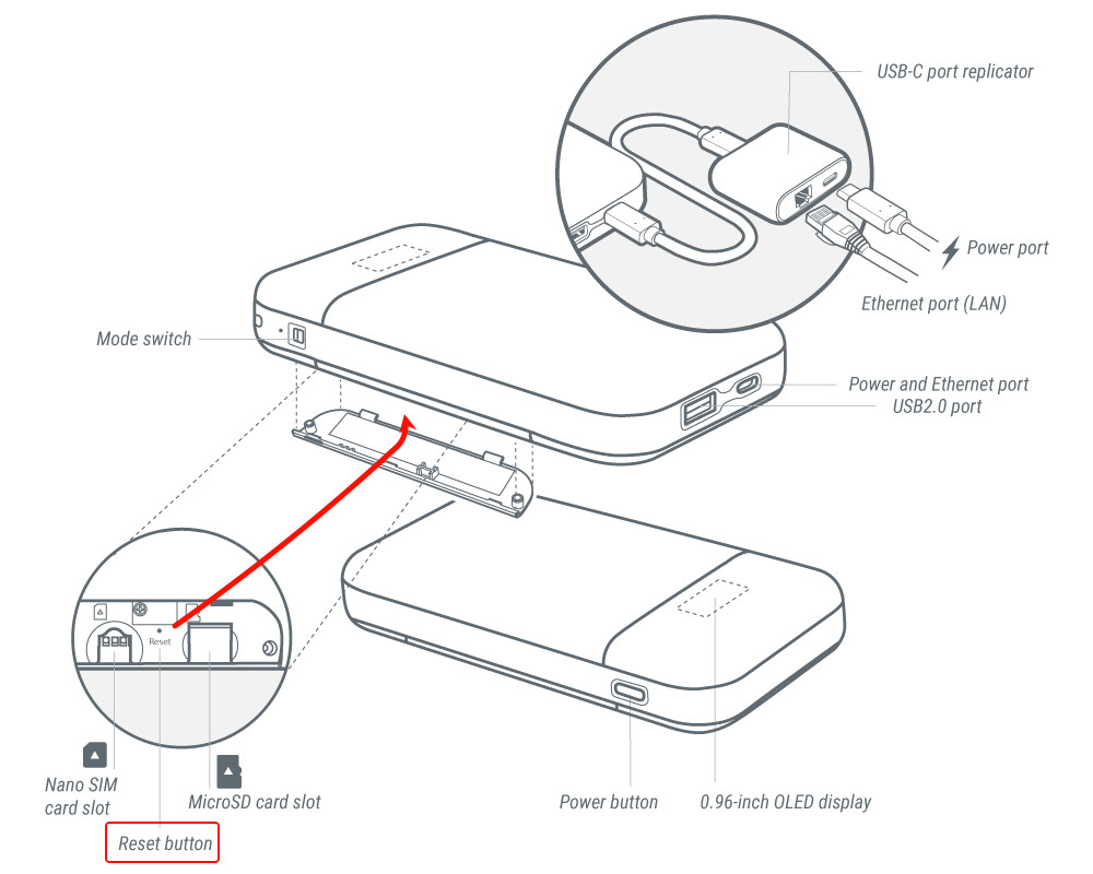

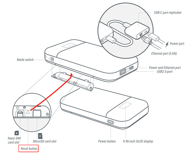

Please try to reset it again, the screen shows the reset button pressing timer, please keep it over 8 secs.

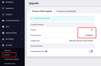

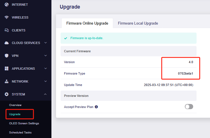

I recommend upgrading to the latest beta firmware v4.7.2. This firmware upgrades Tor to version 0.4.8.9.
Firmware download link: GL.iNet download center
After the router is upgraded and automatically restarted, enable Tor again and it will load successfully.
thanks, it started working now. started booting instead of initalizating and the version works better

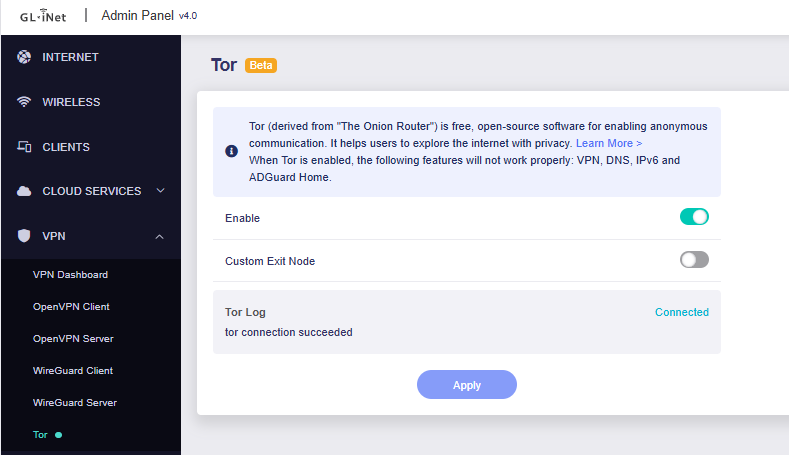

Now finally tor connection succeeded but I was struggling for months. Any idea would be much appreciated why it is struggling to connect.
Should I setup my timezone to UTC?
After our depth investigation, we found that when Tor starts, it takes up too much memory, exceeding the hardware memory size of the device, resulting in insufficient process memory and may not be able to connect normally.
At the moment it is working well with the new beta update
