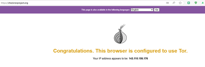

AX1800:
MT2500:
they are in same network, and MT2500 Tor works ok.
Usually it is the network or network configuration problem, did you try to reset the MT2500 and test again?
