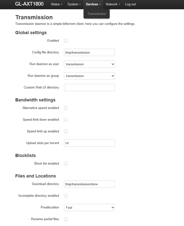

I want to add, today after entering Luci in the menu appeared item - ‘Services/Transmisions’ with settings, but there is no button to open the web-interface management client and can not connect to Transmition Remote GUI, although plug-ins - ‘transmission-web’ and ‘transmission-remote’ installed.

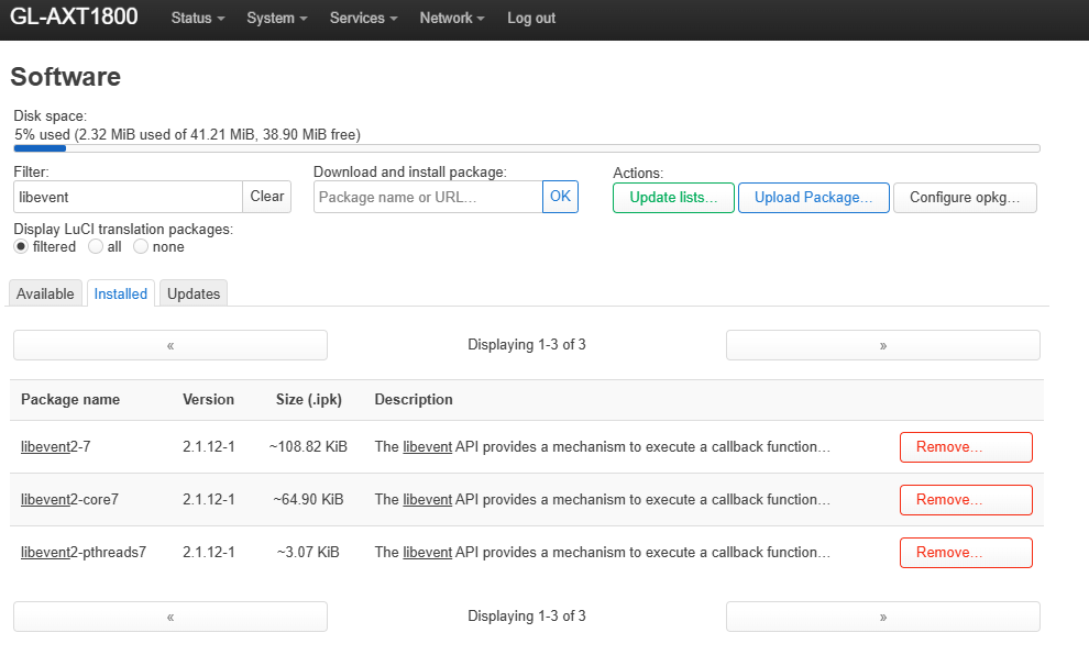

Transmission can not find functions from libevent library, had to open back to 4.6.8 there all torrent client works fine. And when I was looking for the cause I found quite a lot of complaints about this firmware 4.7.0, why does the manufacturer so badly test the product?

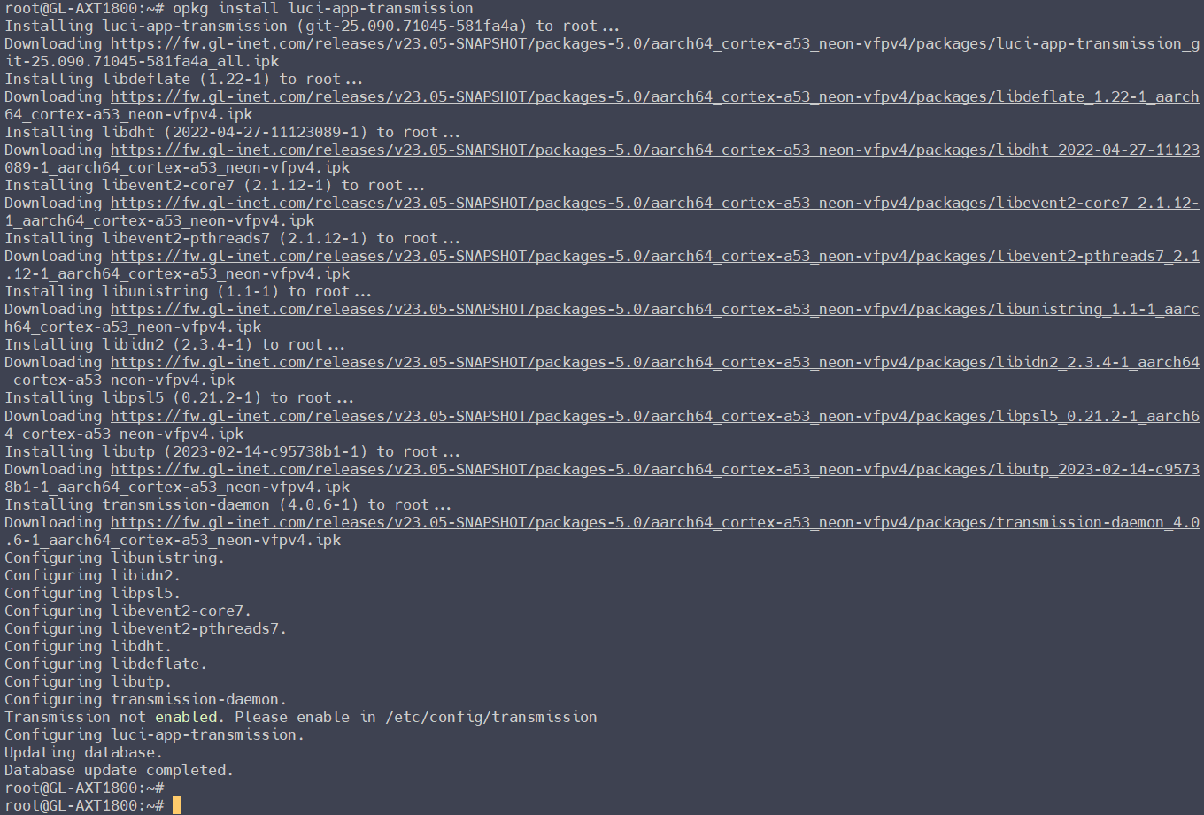

Please try to update the plugins repo first and then install the plugins.
And the Transmission's dependence libevent2 can be installed.
I tried to do it, spent half a day, but it didn't work, so I rolled back to the last firmware. but why release such crude firmware in the first place? Why does the company treat its customers so disrespectfully, forcing them to spend their time on making the product ready?
