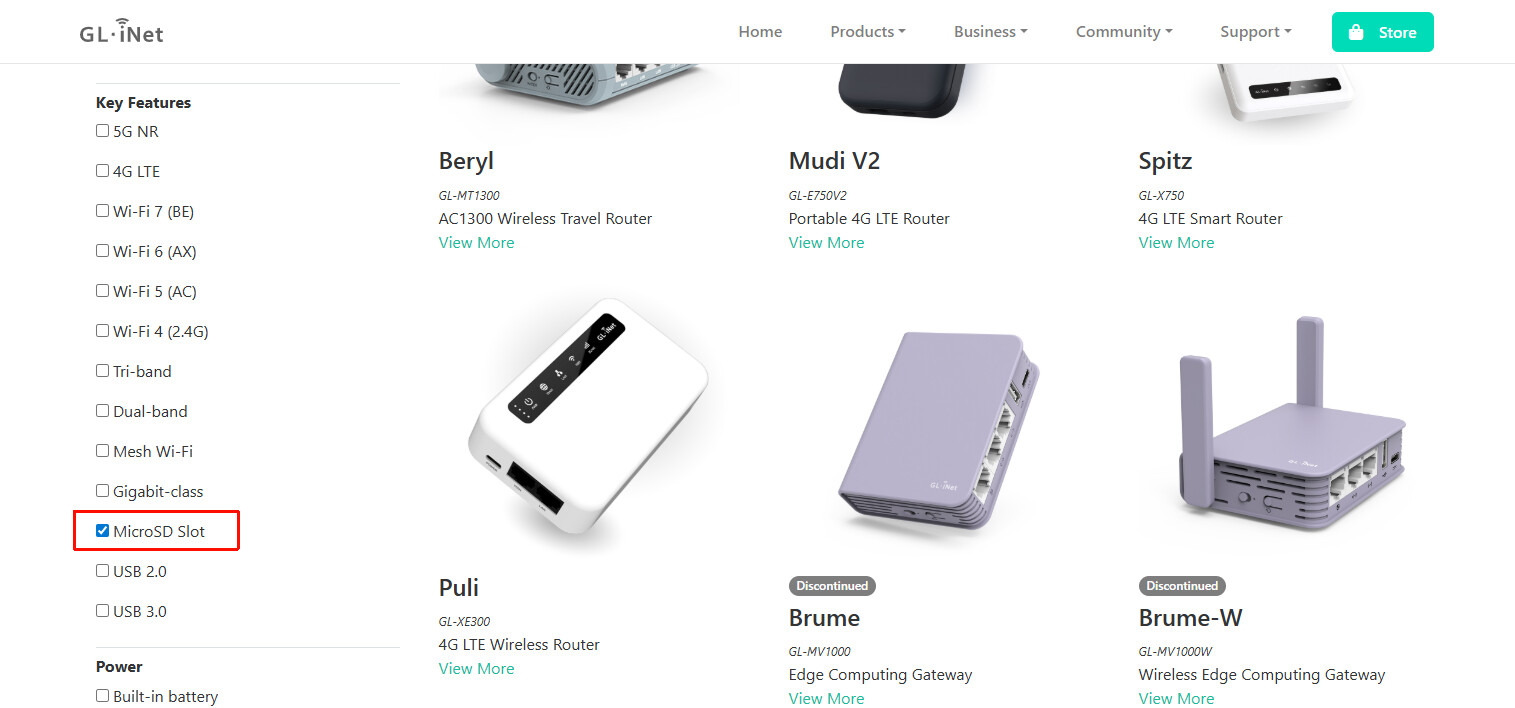

  2. For other models recommend that do have a microSD card slot, you can visit our product page and check the “MicroSD Slot” filter on the left to find suitable devices.
    A nearby option might be the Puli AX (with 5G cellular connectivity and an integrated battery), though it is significantly larger in size.
