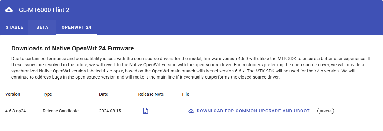

WDS probably is related to the wireless driver of the primary router (Flint 2), may try to upgrade the Flint 2 firmware to the OP24 from the GL download center:
https://dl.gl-inet.com/router/mt6000/

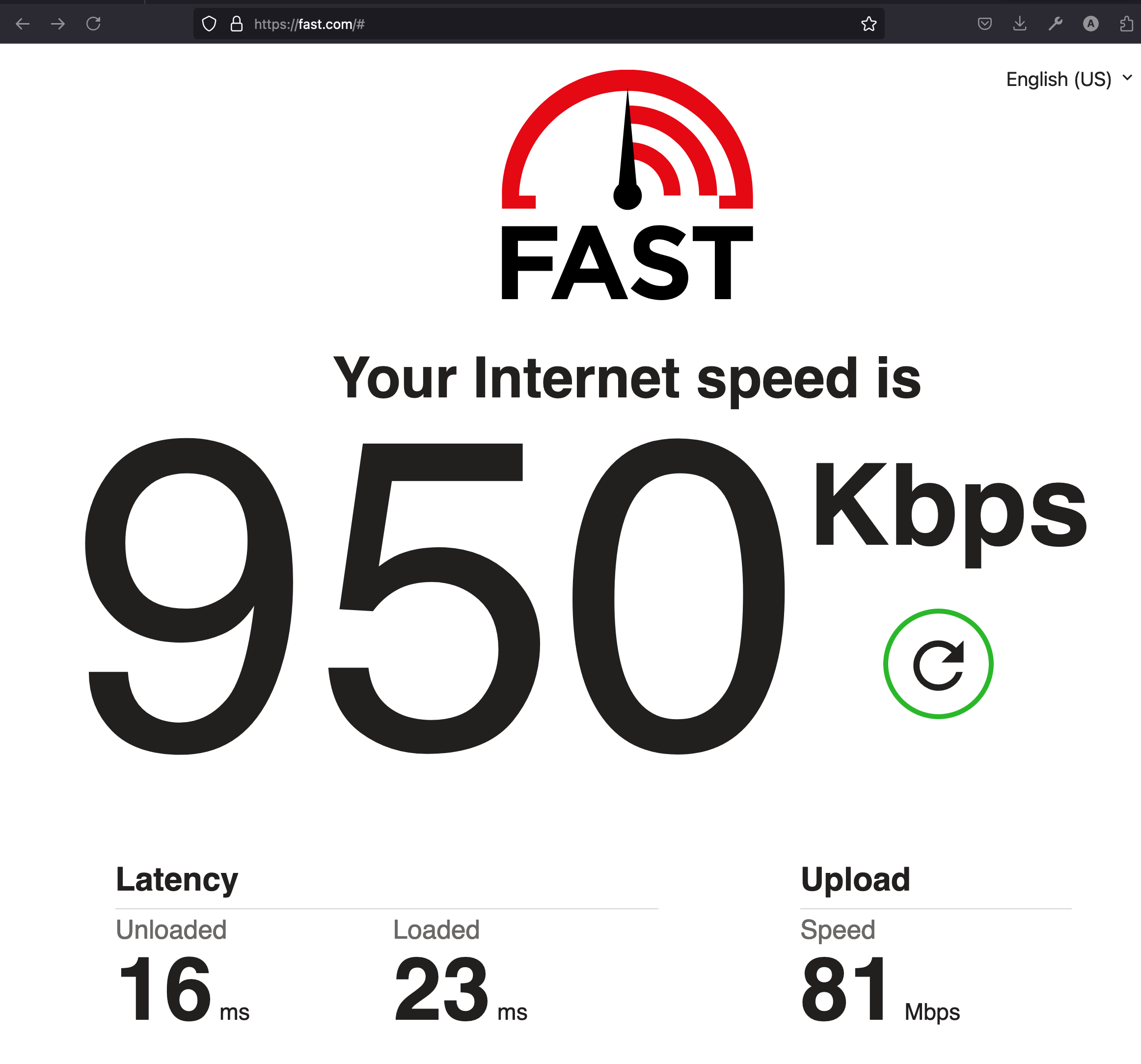

I confirm that the Flint 2 firmware OP24 is working with WDS mode and is getting an IP, but it is extremely slow, with speeds of 1-3 Mbps. is there any alternative solution for WDS ?
Any other devices that are connected to the primary router through WDS mode also so slow?

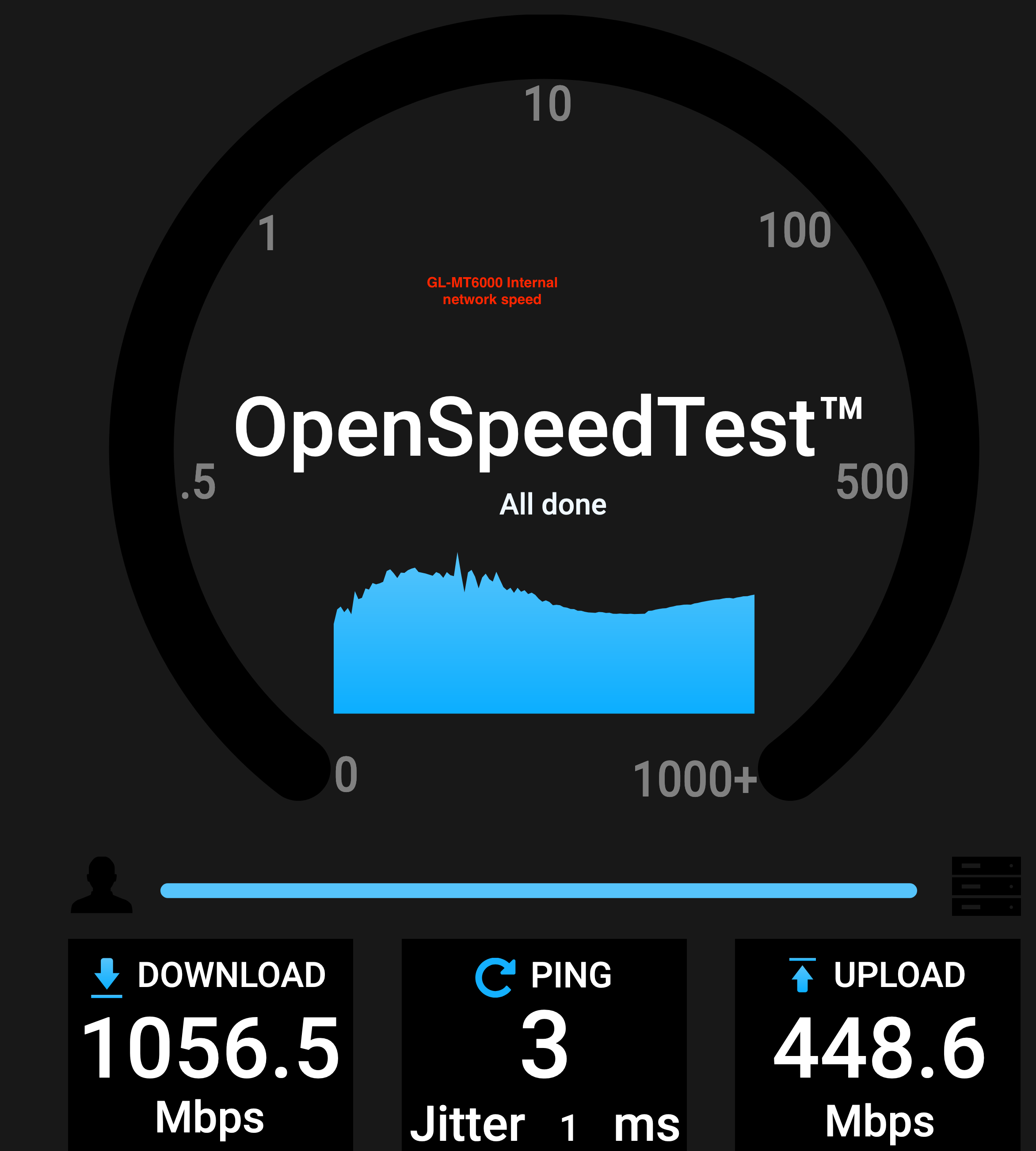

Are you referring to why fast.com speeds are much slower than the openspeedtest?
is the openspeedtest is from the Internet? I only surely the fast.com is from Internet.
Openspeedtest is in my network on one of the servers. The purpose of Openspeedtest is to measure local network speed without using the internet. it is kind of iperf3 to measure local network speed in ui way
do you think it is a bug on GL-MT6000 v4.6.3-op24 ? I am happy to make more test for solution of the bug
The openspeedtest server behind the MT6000 via the LAN, and AXT1800/MT1300 WDS connect to the MT6000, right?
The openspeedtest 350Mbps in the AXT1800, it means the WDS connection works no problem, probably the fast.com have problem, may try others Internet speedtest application, like how about speedtest.net?

However, when I opened https://www.speedtest.net/, it took a very long time to load. Even after waiting for around 3 minutes, the page only partially loaded (as shown in the image I shared) and I couldn’t perform a speed test.
In another test, I connected to the GL-AX1800 Wi-Fi from 1 meter away with an iPhone 14 and again had to wait a long time for the page to load. The result was the same as before.
When I opened fast.net from my computer, the speed results were almost identical to previous tests.
