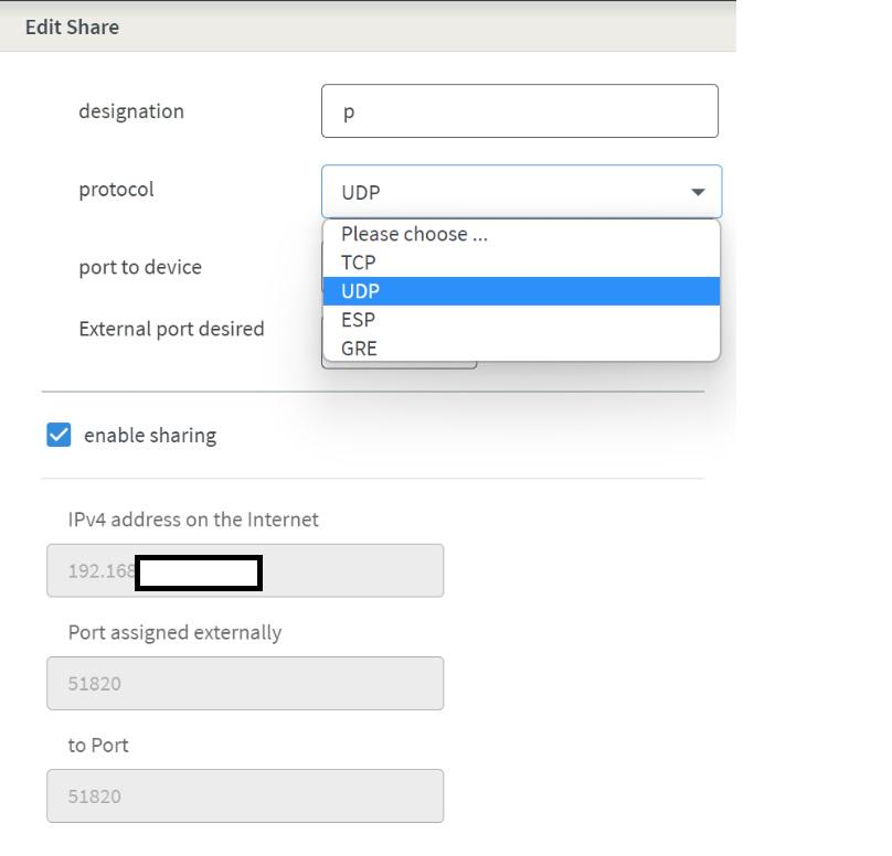

This is the config at the Home Router:
And the options:
Question - should I edit something at the “Flint Level” - on the Firewall/Open Ports on Router?

  1. The “IP address on the internet” looks to be a 192.168.X.X address - which is not an internet routable address. Make sure that your iPhone is connecting to a real internet address.
