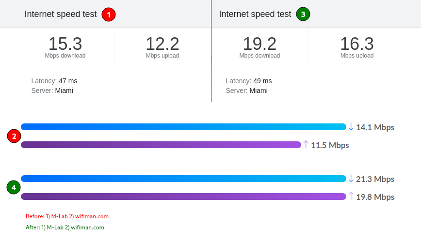

I applied the changes here for ~ 20% improvement:
This is a great writeup, thanks!
