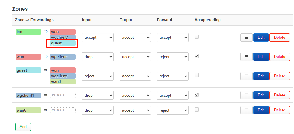

This issue has been raised on this forum a few times in the past but I am still facing problems doing the following:
I want to use my Guest network (wifi) as IoT on my GL-BE9300 running 4.8.1. So, I followed examples based on https://www.youtube.com/watch?v=UvniZs8q3eU to modify firewall settings in Luci to allow LAN to communicate with Guest (but not the other way around). The zone settings look like this.
Guest has also inherited exceptions from the original Guest network for DNS and DHCP in Firewall - Traffic Rules.
However, I am still unable to reach any devices on Guest from LAN.
Any idea why?
Note: my GL-BE9300 is in drop-in gateway mode, with the main router being a GL-AX1800. However, the Guest network and all wifi are running from GL-BE9300.

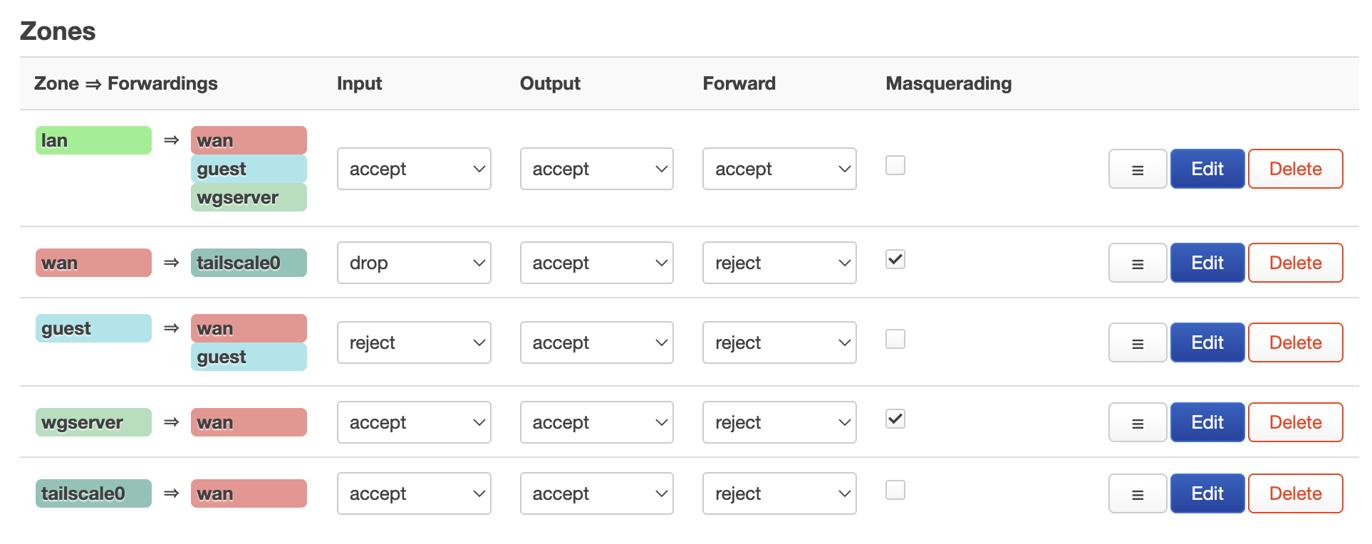

If you want devices on the LAN to be able to access the Guest network, but not vice versa, simply enable forwarding from the LAN to the Guest network in the default configuration.

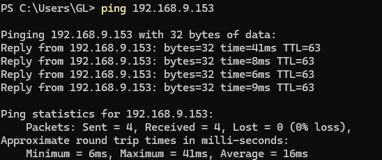

We verified this locally using BE9300 with firmware 4.8.2 beta and drop-in gateway enabled, and it works as expected.
Please note that if you need to access devices on the BE9300 Guest network from the AX1800 LAN, it also needs to do:
  1. Configure a static route from the AX1800 to the BE9300 Guest network.
  2. Configure the BE9300 to allow WAN-to-Guest traffic forwarding.
Thanks!
