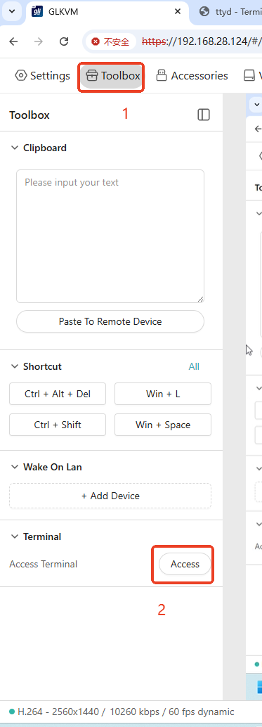

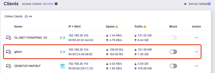

  1. Try opening your kvm web page in your browser:
Log into your router’s admin page and check your KVM device's local IP address (for example: 192.168.28.124 ).

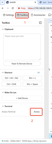

  1. Enter that IP in your browser, log in using your password, then click “Access” to open the terminal.

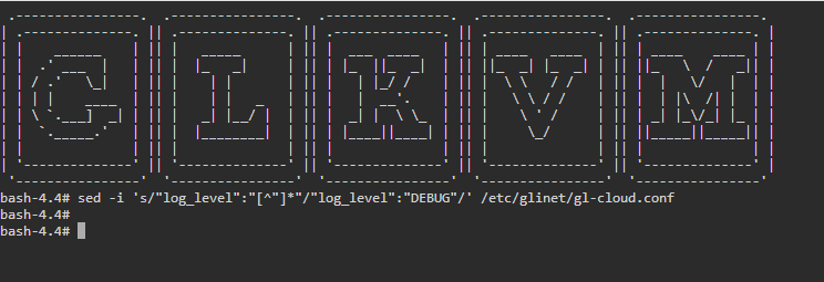

  1. In the terminal, copy and paste this command and press Enter:
sed -i 's/"log_level":"[^"]*"/"log_level":"DEBUG"/' /etc/glinet/gl-cloud.conf
:light_bulb: Tip: This enables debugging logs. It won’t affect how the device works.

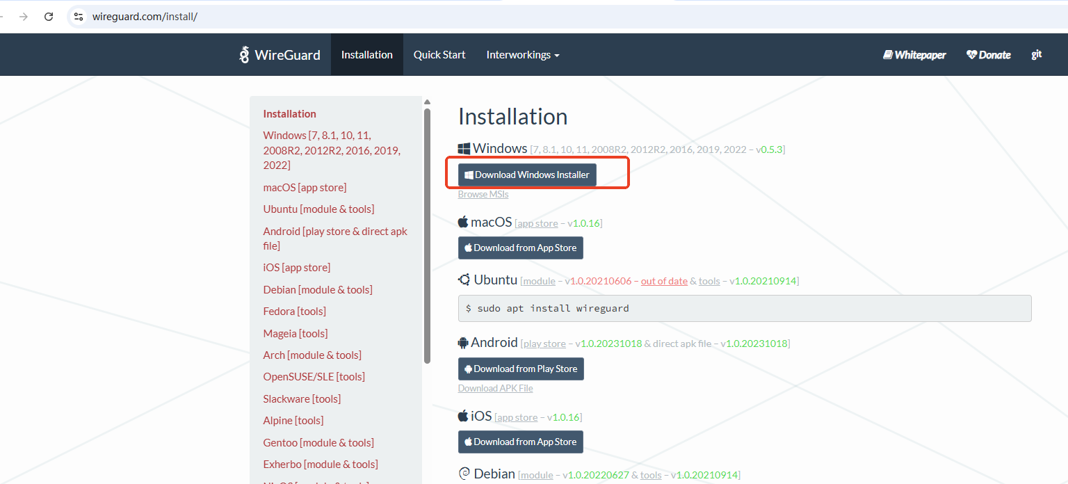

Step 2: Install WireGuard on Your PC (for connection analysis)
  1. Visit the official download page::Installation - WireGuard
  1. Click the Windows version to install.
:puzzle_piece: We’ll use this tool to check your connection status later.

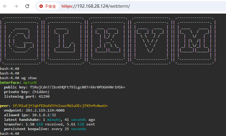

  1. In the KVM terminal, run the following commands one by one and take a screenshot of each output:
wg show

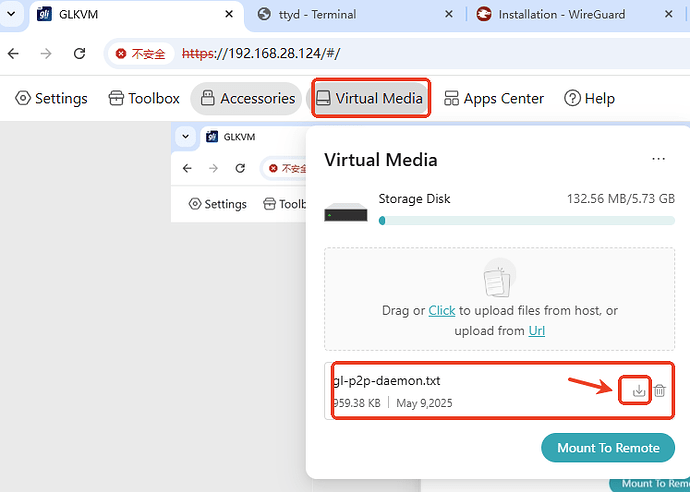

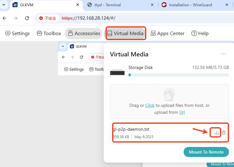

  1. Then generate a log file by running command:
logread | grep gl-p2p-daemon > /userdata/media/gl-p2p-daemon.txt
  1. Go back to the main web page and download the gl-p2p-daemon.txt file.

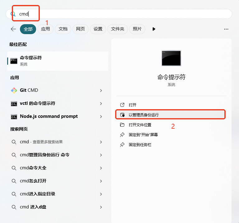

:pushpin: Part B: Collect Information from Your Windows PC
  1. On Your Windows PC,press the Win key, type cmd , then right-click and Run as administrator.
  1. In the Command Prompt, enter:
wg show
  1. Take a screenshot of the output.

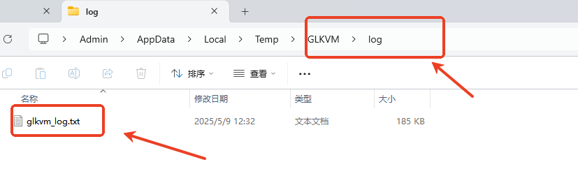

  2. Then go to the log folder (depending on your username and install location):
C:\Users\<YourUsername>\AppData\Local\Temp\GLKVM\log
Example: C:\Users\Admin\AppData\Local\Temp\GLKVM\log
Look for a file named something like glkvm_log.txt and save it.
If the file doesn’t exist, no problem — you can skip it.
