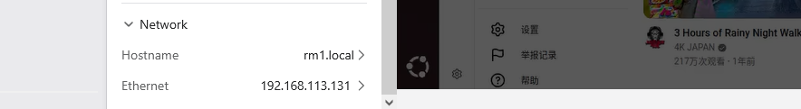

The glkvm.local on the GUI is just a display. You should focus on the domain name in the browser's address bar.
This is just to inform you that you can access it through this domain name. The device does not have any binding relationship with any domain name.

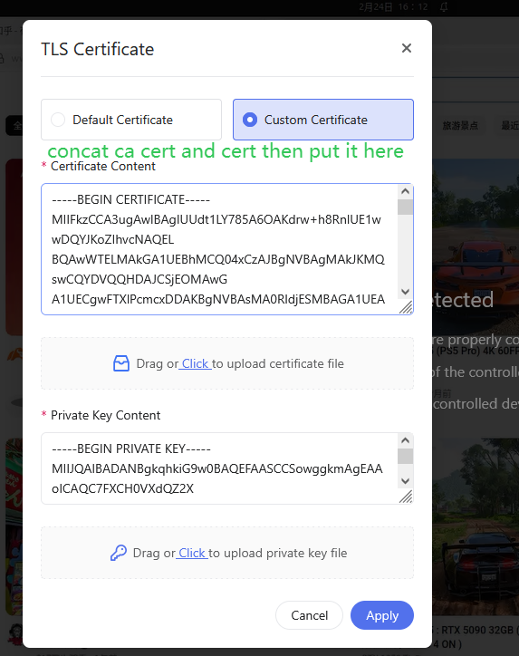

It seems you should have three inputs: CA certificate, certificate, and private key. You need to concatenate the CA certificate and the certificate, then place them into the certificate input box.
Do you mean to say this needs the full certificate chain?
yes

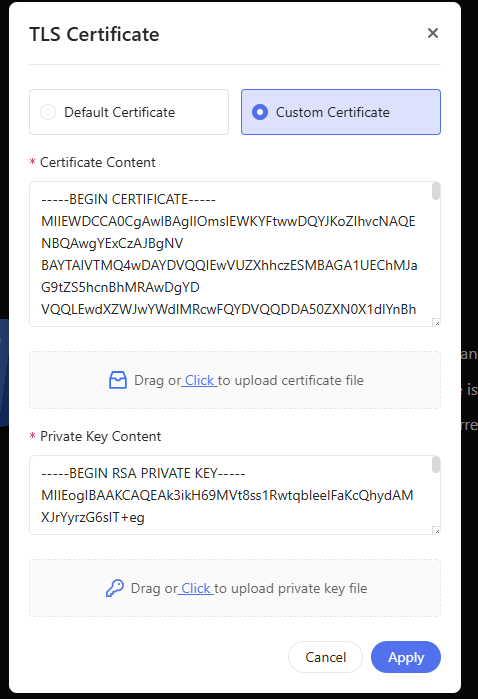

I have exported the full cert chain in .pem format (which should be PKCS#1), and I tried both .pem and .pk8 for the private key, and it still threw the same error.
@minmie This still isn’t working. I’ve clicked the “Custom Certificate” radio button, pasted my host, intermediate CA, and root CA certificates in order (although, according to the pre-populated text, the intermediate and root certs should be optional), and pasted my private key for the host cert in the appropriate box, and I’m still getting the “TLS certificate setup failed, please check the certificate content and key.” error. As @matta reiterated from my original post, if would be great if we could get additional details as to why this is getting rejected. It would be even better if any documentation existed that outlined the expected format, chain order, etc. Without this feature working, it really limits the usefulness of the device as we can’t ensure host identity is authentic.

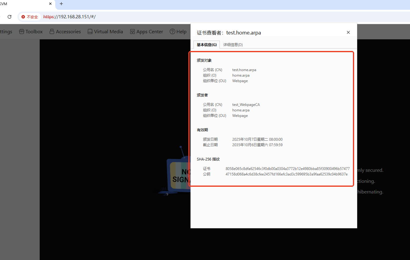

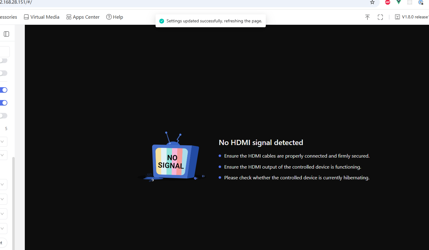

Hi @matta ,
We tested the certificate file and private key file you provided on our side using an RM1PE running V1.8.0 release1, and the certificate imported successfully without any errors. TLS setup completed as expected.
Could you please double-check on your side and confirm that the import is still failing?
Here is our test result:
